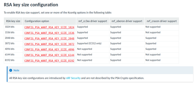

1) I have a requirement to implement RSA OAEP(SHA1) public key encryption using 3072 bit keys. The CryptoCell on the nRF5340 has a upper limit of 2048 bit keys. The question is, how can I implement the required encryption operation? Is using mbed_tsl directly an option or is the 2048 bit key limit also imposed on this API?
2) When attempting to do RSA OAEP(SHA1) using a supposedly supported 2048 bit key, this fails with return code -147 (PSA_ERROR_HARDWARE_FAILURE). There are no sample code performing RSA public key encryption using the CryptoCell, is this operation not supported?
    For a quick look, I were not able to figure out what the Mbed TLS key limit would be.
    From our Driver configurations and supported features:
    "If a specific cryptographic feature is not supported by a PSA driver but the algorithm is configured to be used, then Built-in Mbed TLS will be enabled to ensure the feature is available."
    So you can use Mbed TLS for this from the PSA API.
    Using the Mbed TLS API directly is also an option, but I recommend trying the PSA API first.
    Can you try to use Mbed TLS to do the same operation, and see if it works that way?

    We want to use the CryptoCell, so our requirement has been lowered to the supported 2048 bit keys.
    I have used the code sample from the nRFSDK 2.1.0 called RSA that performs RSA signature and signature verification.
    As described this sample fails at my end, when using the nRF5340DK board with error -133.
    I have attached the sample including my enhancements to perform RSA encryption.
    Per default, encryption is tested. Signature can be tested by uncommenting the line:
    #define TEST_RSA_ENCRYPTION (1)
    The test shows:
    1) RSA signature/verification fails with -133.
    2) RSA key generation using keys above 1024 bits hangs the program.
    3) RSA encryption using key size 1024 fails with -133.
    We need to perform a 2048 bit RSA OEAP operation, which should be supported according to the documentation / nRF5340 datasheet.
