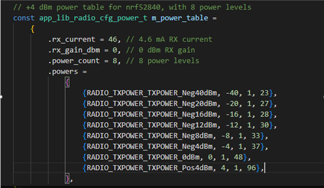

First, we modified the files related to the power table, extracted from the radio module from nrf52 and wirepas SDK (C:\wirepas\wm-sdk\mcu\nrf\nrf52\hal\radio\radio_power_table_nrf52840_4dBm.h)

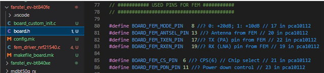

The used pins, according to the BT840X information page 18 (static1.squarespace.com/.../BT840F_Product Specifications.pdf)
(The pin 13 is not the one where the antenna is connected, but we were uncapable of finding this pin and we don’t know if it is mandatory to turn on the FEM).

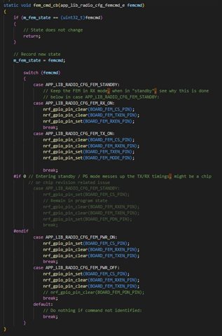

The different FEM states, related to the SKY66112 documentation, page 5 (www.skyworksinc.com/.../4C7B484628BA46BDADCB2E2AACDFA1ED.pdf)

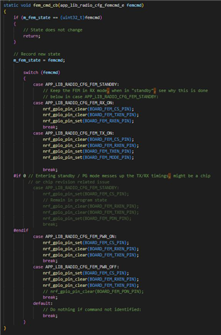

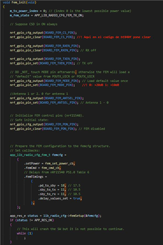

This is the Fem_Init() function, with all the pins configured according to the TX state at the beginning as the sky66112 datasheets indicates:
Finally, our problem: We are uncapable of turning on this FEM. We read all the documentation, where indicates that this FEM consumes around ~300mA. We use a power supply so we can measure the current that our node consumes. Even when we tried multiple different strategies and different boards, the current consumption is always 10-20mA.
