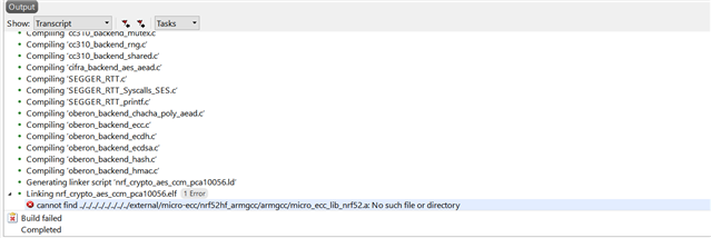

Thank you for the reply, I am working NRF52840, which is used to send data received over UART to mobile app using uart service. I have enabled pairing and bonding, but i also need to encrypt the data sent after pairing.
When i compile the Crypto:AES i am getting this error
How do i know the data i am sending is encrypted?
