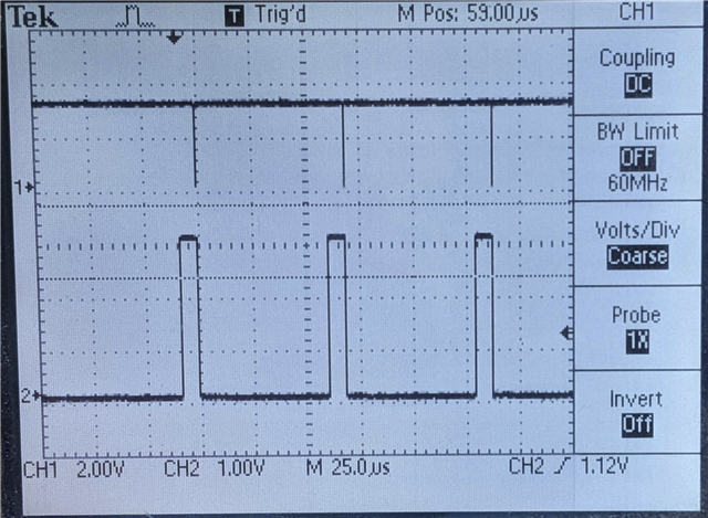

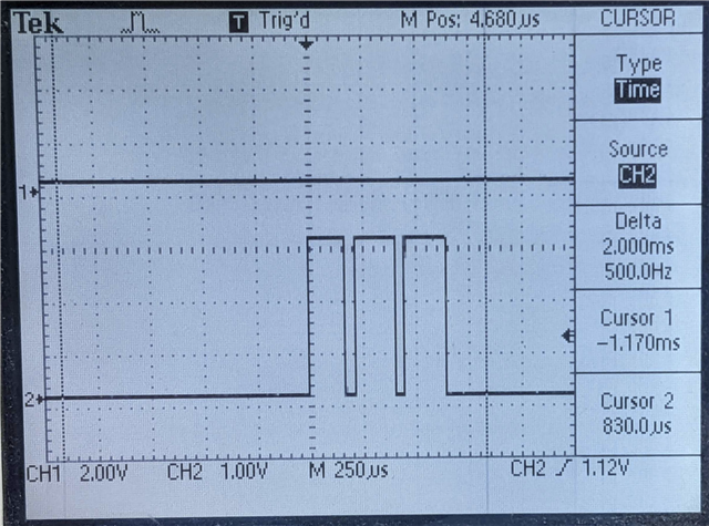

Below is a scope shot of the default behavior when the system boots up, where the example code is working in grant mode, meaning it is allowed to send packets. I confirmed that I see RF transmission coming out of the module. This works as I expected it to. The GRANT signal is high, and BLE is allowed to transmit messages. I am able to sniff packets with another NRF52 set up as a BLE sniffer with Wireshark.
Once the "d" character is sent to the demo code it denies RF transmission by driving the GRANT signal. I am able to confirm via a BLE scanner that no messages are getting sent. As you can see, there is a very short pulse on the grant pin which prevents the BLE system from transmitting. I expected to see the GRANT line to go low to prevent transmission, but the fact that it is low for such a short period of time I find strange.

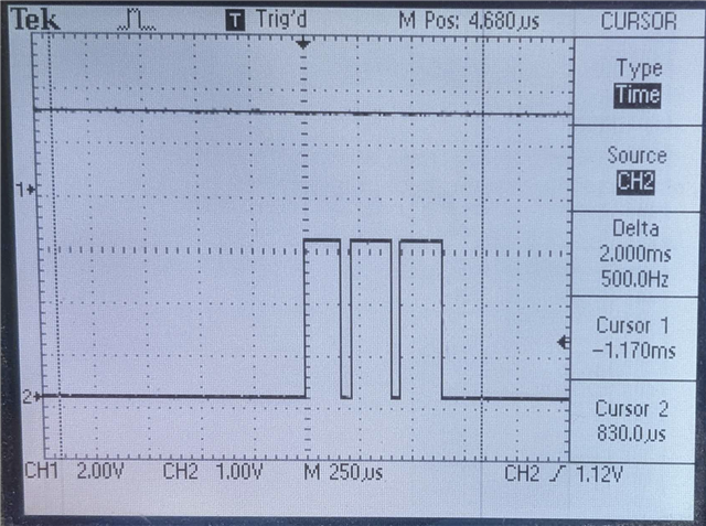

Next I connected the grant signal to GND to force it to be low. I expected that holding this line low would prevent any transmission, in a "big hammer" method vs denying each transfer individually. However, that is NOT the case. Holding the GRANT line low has no influence on RF transmission. I see the NRF52 advertising messages on my BLE sniffer.
