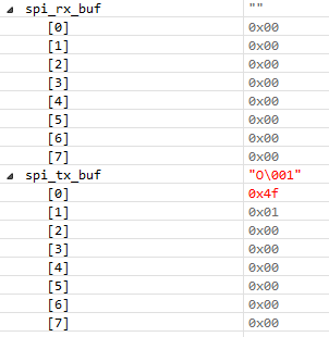

Reading magnetometer LIS2MDL via SPI
using segger v5.66, SDK 17.1
My hardware has 4 wire SPI lines running to magnetometer, Initially I was unable to read the WHO_AM_I(4F)  register. After going through the datasheet I came across this
so I was suspecting this was actual problem because of which I was unable to read register
The information given in datasheet I don't understand completely what to be done, Here is my current code

int lsm2_read_reg(char reg)
    spi_tx_buf[0] = SET_READ_SINGLE_CMD(reg); //creat read comd
    spi_xfer_done = false;
    APP_ERROR_CHECK(nrf_drv_spi_transfer(&m_spi, spi_tx_buf, 2, spi_rx_buf, 2));
    while(spi_xfer_done == false){}
    return spi_rx_buf[1];
    int interRegValue;
    spi_init();
    NRF_LOG_INFO("Spi application started");
    interRegValue = lsm2_read_reg(ADD_REG_WHO_AM_I);
    if(interRegValue == WHO_AM_I_DEFAULTvalue)
        NRF_LOG_INFO("WHO AM I value is correct");
    while (1)
So now, I dont understand how do we interface this
