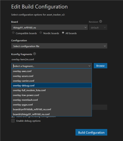

  • Are you able to rebuild your project with the overlay-debug.conf? This should provide more information for our developers to see what is going on.
    Thanks!
  • How exactly should I do this? I can see this already in the kconfig:
    rsource "src/modules/Kconfig.debug_module"
    and I do see the overlay-debug.conf in my file browser in vs code.
    If I select debug options when creating the build configuration the build fails, which I already reported here:
    https://devzone.nordicsemi.com/f/nordic-q-a/96553/build-configuration-fails-for-sdk-2-2-0/409413
    I am not talking about the debug options in VS Code, this is the debug configuration which enables misc. debug settings in the application itself.
    In VS Code you can add this to your build configuration under Add Fragment, which will give you a dropdown menu of available overlay config files
