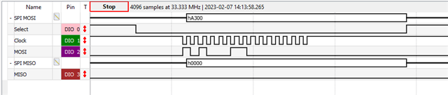

Thank you this helped alot! I am having one issue where it seems my write command isnt going to register correctly. I am trying to write hA300 to my device (AD7380) and doesnt seem to be storing into the device properly. The waveform looks good to me wondering if is related to the drivers.

Chris Westerhoff said:I am trying to write hA300 to my device (AD7380) and doesnt seem to be storing into the device properly.
How do you tell it does not work properly? Sorry, I do not fully understand. Perhaps you could add a few words? I will in any case take another look tomorrow morning.
I figured out what was wrong the clock phase was set incorrectly on my end.
Thank you for your help!
-Chris
Thank you for the update. Great to hear that you figured it out!
