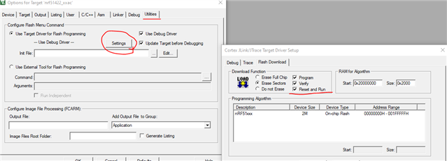

So if I set an option to create a blood pressure cuff in each model, when I build and flash the tunnel model onto the nRF51 DK, the program starts. If I press a button to start advertising, the client sees it, it connects, pairs, and transfers data.
However, when I build and flash the GHS model, I have to press the BOOT/RESET button for the program to start. From then on, it works fine, just like the tunnel model. A power cycle also requires no RESET. Just post-flash.
In debug mode, there is no need to press the BOOT/RESET button.
Any idea what I might be doing wrong in the GHS model? What would cause the flash not to start such that a RESET would solve all the problems.
