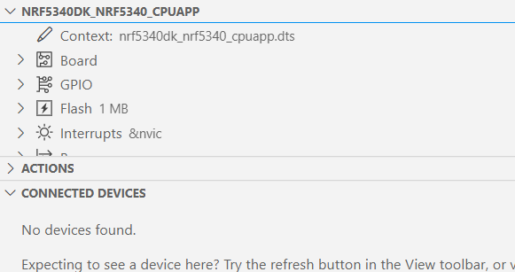

and one more thing i want to add custom board for flasing but it always shows only the dk in flashing section like below but in connected devices custom board is visble so how can i add my custom board in existing code so that i can flash
NOTE: now i have not connected custom board that why it shows no device found and also please dont tell me to refer other documents because documents are not clear regarding this..show me some example
