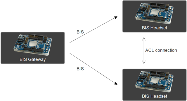

I am trying to develop a LE Audio product with a system like the attached image.
Both BIS and ACL are sometimes successful, but often the ACL disconnects.
According to debug messages, the disconnect reason at that time is both BT_HCI_ERR_CONN_TIMEOUT.
So I don't think one of them got reset.
Are there conditions for maintaining both BIS and ACLs? (For example, the relationship between ISO Interval and Connection Interval.)

    The reason for this could be that there is overlap between the BIS and ACL events, which leads to one of the devices not responding for a long enough time to trigger the connection supervision timeout.
    Just for clarity, which bitrate is the BIS using, and how many retransmits are you using?
    In general, we recommend that the ACL connection interval is a 2x multiple of the ISO interval, which is 10 ms in the nrf5340_audio application. What ACL connection interval were you using in your tests?
    We are also aware of an instability in the current LE Audio Controller when the ACL connections are updating their connection parameters while the ISO is active. I would therefore recommend that you finish all the parameter negotiations of the ACL link before you open up the BIS.
    Please try this, and let me know if you still are seeing an issue.
