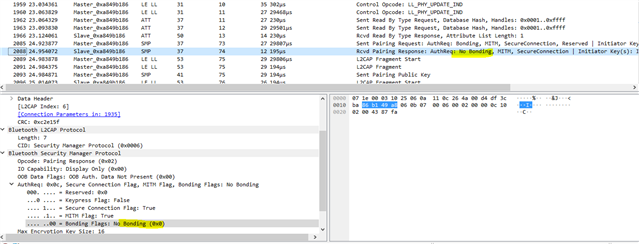

non-bondable pairing in nrf-connect sdk
I'm trying to configure the BLE stack as non-bondable pairing only so that it requires pairing by every time the smartphone tries to connect to the device (the bonding is not required). I changed the prj.config and the code, but it seems to work with iPhone but not with Android.

Could you please tell me what else I need to modify or change to get it working on Android?
Current behavior on Android phones.
My first connection works fine ( it requires pairing ) but the second connection doesn't require the pairing key so it fails since the hardware executes by every disconnect  (
bt_unpair) bc, I want the user enters Passkey by every time the connection is established.
. It seems that the android phone thinks that it has the right authentication keys  (the second time) so it fails and deletes those keys after failing. Afterward, the third connection works fine and it requires again the pairing key. so result the one connection works second one does not and so on.
Thanks in advance!

  • Hi Mustafa,
    I did the test and I can see that if I set CONFIG_BT_BONDABLE=n the nRF52 will have No Bonding flag set in the authentication req flags:
    So you don't even need to call bt_unpair () when disconnected. There shouldn't be a bonding with the flag No Bonding. I'm not so sure why the phone doesn't follow the flag and still keep the bond information. After the device reject the encryption request, the phone disconnect and delete bond.
    I think it's more like a phone's issue. I did the test here with 2 phones. On Android (Samsung S22) it showed the exact behavior as you described. Second connection doesn't work, and the third one works.
    But on Iphone, it worked as expected. The Iphone doesn't store bond information if the bonding flag on the peer doesn't set.
    I couldn't think of a work around here except for that you can, in your phone app, automatically reconnect if there is a disconnect quickly after connection. Or you can check if there is bond information of the device on the phone, you can delete it from the app, the same as the "Delete bond " button we have on nRF connect app.

  • Hi Mustafa,
    Could you send the full project ? It 's easier for us to compile it here. And a hex file if possible.
    I modified the SEC_PARAM_BOND= 0 and change
        sec_param.kdist_own.enc  = 0;
        sec_param.kdist_own.id   = 0;
        sec_param.kdist_peer.enc = 0;
        sec_param.kdist_peer.id  = 0;
    And got the same result as with Zephyr. I think it may have something to do with the phone.
