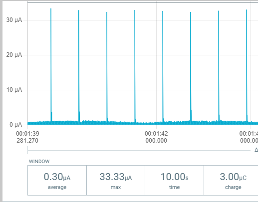

    Yes, it's a BLE application. It has a few timers to measure sensors, battery level etc. It draws too much current (about 5 ma) and I am searching for the reasons(s). I need it to advertise once per 5 sec, and when connected to use as low power as possible, with connection intervals of 250 - 500 ms.
    I see. Just to ensure that the HW and your measurement setup is ok. Can you flash your custom board with the Ble_power_profiler application and report what current you measure?

  • I am using PKK2, with  ble_power_profiler, when system stop (before clicking the button) the current is 0.3uA.
    Ok, this is about what I would expect when measuring the current consumption of that example, which probably means that your HW and measurement setup is ok.

    Can you also share a plot from the PPK2 when measuring your application that shows the 5 mA current?
