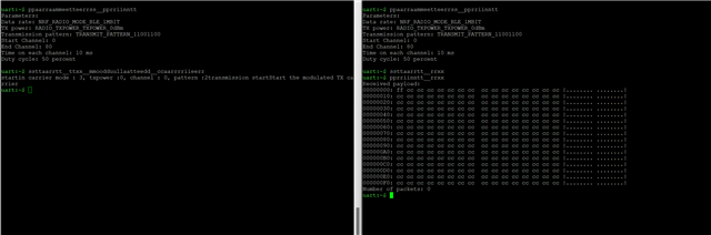

  • Also, I am following this method for now to test and from what I understand, when transmit_pattern is 11110000, I should get F0 and if it is set to 11001100 I should get CC at the receiver side. Am I right here ?
    If that is the case, am I right in assuming that there is no way by which I can make sure that the changes that I make to the output power using output_power command in transmit side actually has an effect ?
  • Yes, that is was I expect as well. I checked the shell commands for the sample, it only accepts the values pattern_random, pattern_11110000, and pattern_11001100 as values for transmit_pattern.
    Can you share a transcript/log of the shell sessions for the transmitter and receiver? I just wanna double-check that it is set-up properly.
    As for a HW design review I suggest you open a new 'private' ticket and ask for a HW review. You can link to this ticket and it'll be delegated to me if I'm available.
    We will need schematics and layout files, as well as a BOM for the crystals and passive components in the RF domain.
    Here is the log. I believe it is working as it should be. The only problem I have here now is that I have no way of verifying the output_power set by the transmitter. Is there some way i can verify that too ?
    Thanks
