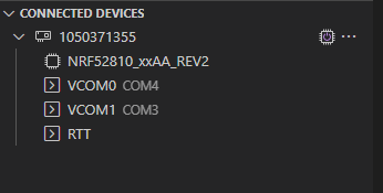

Next, I connect my new target board to P19. Then I see this:
The new target is based on the 52810 so all looks as expected.
