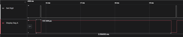

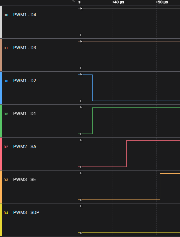

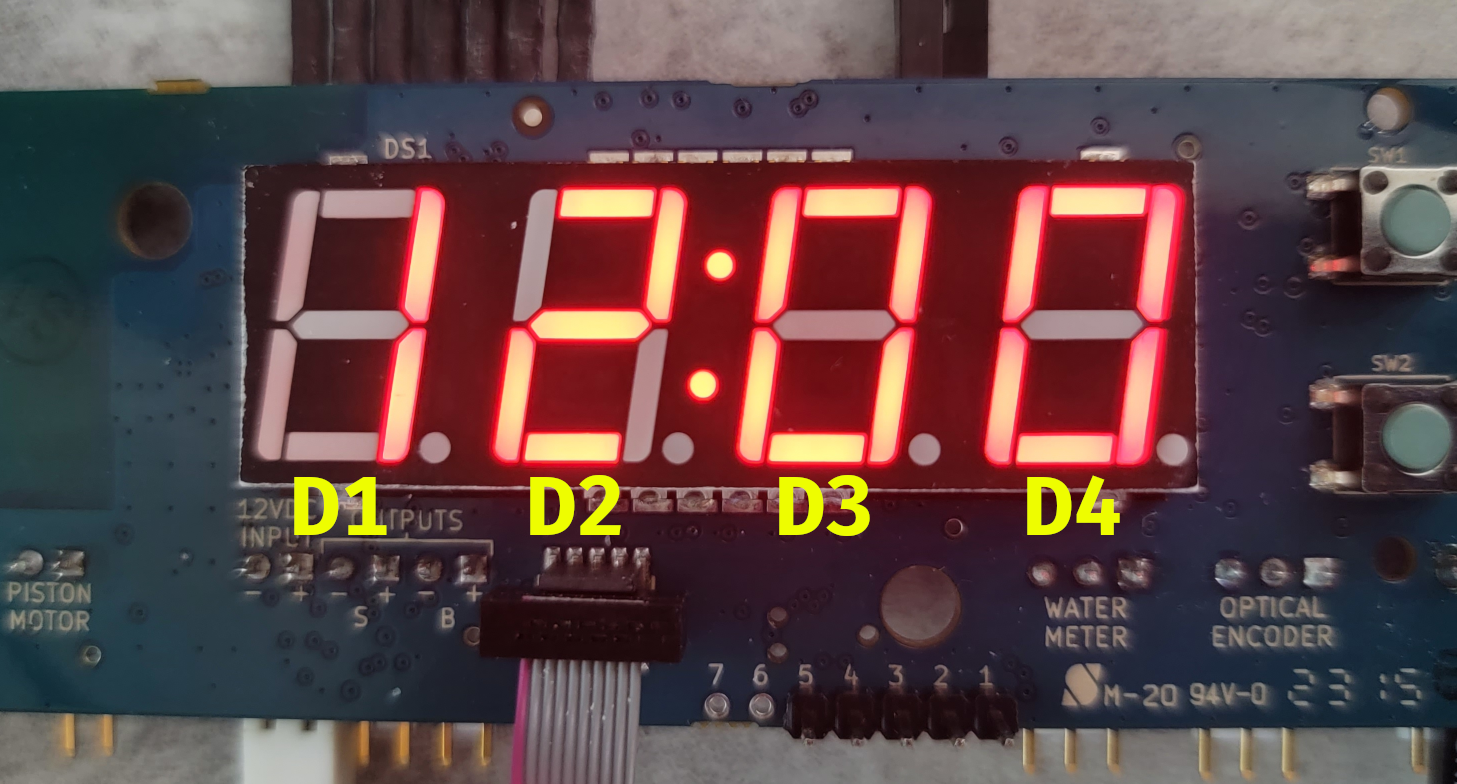

We have a 4 digit 7 segment display that we use on one of our products. Instead of using something like timers to keep the display updated we designed it to use PWM interrupts instead. So every time an interrupt happens we increment the current digit and set the PWM pulse cycles / brightness. The PWM is inverted and it's set to use a 4ms period. So, each segment can have a min brightness of 4ms - 100us (3,999,900ns) and a max brightness of 160us (160,000ns). We never use full brightness (0ns) or no brightness (4,000,000ns) because the interrupts would get disabled and cause the display to no longer work. This has been working great, but we noticed there was a "bleed" on the display (some of the segments are partially lit when they shouldn't be). After looking into it we found that the interrupt callback timing was not consistent. The callback gets fired usually around 130us to a little over 200us (normally around 150us). This is causing the digit switch to be delayed, which partially lights a segment up. This all goes back to the max brightness; the lower the value the more it bleeds and the higher the value the more stable it is (but at the sacrifice of a dimmer display). Here is a visual example of what we are seeing:

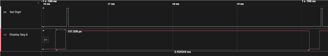

"Set Digit" (the top reading) happens as soon as the interrupt callback is fired. The "Display Seg A" is a wire hooked to the capacitor that the segment A LED uses.

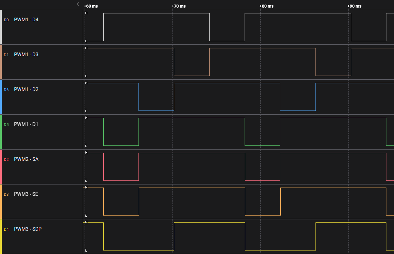

Here is what it should look like and has no bleeding (you can see it fires before the period starts giving it enough time to switch digits properly):

    I was researching this some more and found out that it was a timing issues caused by the ADC (it appears the ADC was throwing everything off). I had the ADC configured to sample using PPI / Timer sampling 3 channels at the same time every 500us and it's setup like:
    static bool adc_configure(void)
        const nrfx_saadc_adv_config_t adv_config = {
            .oversampling = NRF_SAADC_OVERSAMPLE_4X,
            .burst = NRF_SAADC_BURST_ENABLED,
            .internal_timer_cc = 0,
            .start_on_end = false,
        //... Setup channels, calibrate, etc.
        return true;
    static void event_handler(nrfx_saadc_evt_t const *event)
        switch (event->type)
            case NRFX_SAADC_EVT_DONE:
                // ... Process Samples
                nrf_saadc_task_trigger(NRF_SAADC, NRF_SAADC_TASK_START);
            default:
    However, this was causing erratic behavior:
    If I change the code to the following:
    static const bool adc_configure(void)
            .start_on_end = true, // <---------- Change to true
        return true;
                // Do not trigger start task
                // nrf_saadc_task_trigger(NRF_SAADC, NRF_SAADC_TASK_START);
            default:
    Then I get consistent / expected behavior:
    I still don't get the PWM callback for ~150us, however, it has not gone over the threshold and caused the other segments to bleed either. I'm going to cleanup my code and flesh out the callbacks and see how everything runs.
