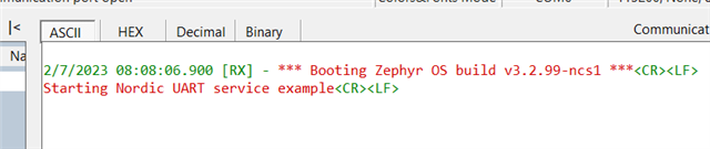

    Same results on where it hangs up (bt_enable).  It is able to printk to the USB port.  The app is resetting every 1/2 sec and sending the reset ASCII message to the USB.

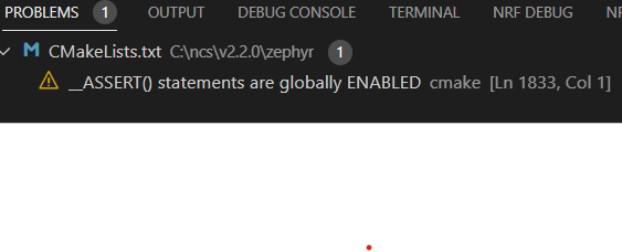

    Can you add CONFIG_RESET_ON_FATAL_ERROR=n to your project config file, this will prevent the program from resetting when it hits an error. The serial log should specify the error causing the program to assert. Can you share the log output?

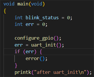

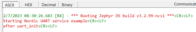

  • added printk to main
    pristine build
    uart init succeeds
    trying to connect from android terminal
    "connect failed gatt status 62"
    also LED1 is blinking - 1 sec rate

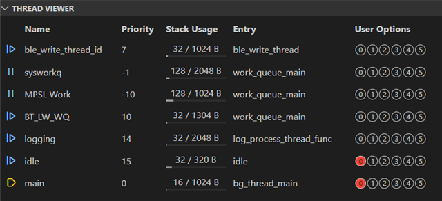

  • Still fails at the same place.
    I deleted all nordic apps and directory's from my windows 11 pc.
    Reinstalled - no change
    Tried older toolchain - no change
    it's not advertising - my android terminal emulator remembered it from the factory ship pairing
