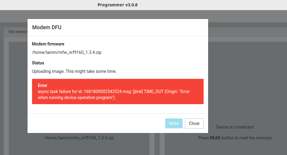

    c) nRF Connect Programmer v3.0.8:
  • Update: After trying 20 times with mfw 1.3.4 and 1.3.3, I could flash mfw 1.3.2 on first try and then upgrade to 1.3.4 without problems.
  • It didn't solve my problem. I also tried earlier firmwares, but nothing worked. However, I downloaded the first item in the firmware history whose name is "09-10-2019_c9c833b1" with description "Precompiled firmware package for nRF9160-DK". Then, I opened and wrote "nrf9160dk_at_client_09-10-2019_c9c833b1.hex" to modem. And after that, I was able to write any firmware to modem.
