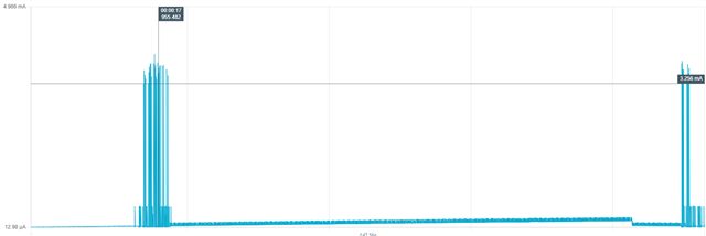

  • Hi Raoul,
    I have been experimenting further with this and using a PPK2 I have a few more questions:
    I have tried initializing SPI using two approaches: Zephyr and nRFX
    Zephyr
    To make things easier, I worked with the SPI_bitbang library, but removed all logs from the prj.conf file. Using this approach, I got 2mA of current. Seems SPI_bitbang draws a significant amount of current, unclear as to why that is.
    nRFx
    I have determined with the old nRF5 SDK that with just spi driver init with the following configs:
    mode = SPI_MODE_0, frequency=125k, bit order=MSB first, IRQ=2
    current is roughly 2uA.
    With the new nRF Connect SDK and the same initialization I see the following:
    The current consumption for some reason ramps up from 5uA to 100uA. Eventually it drops down and stays at 5uA. I'm not sure as to why this ramp up occurs.
    Only thing I could think of is a compatibility issue with nRFx drivers and Zephyr RTOS causing this...but even so I'm not sure how to make it work with the Zephyr approach.
    I would suspect with an nRF52833 just doing SPI init would draw around 5-10uA. So I'm not sure how to proceed with either the nRFx or the Zephyr approach.
    Rahul
  • Hi Rahul, sorry to let you wait.
    That's quite a difference in power consumption. First of all, are you using Zephyr's power management features at all? If not, that is definitely something to include.
    Further, Zephyr SPI has both a bitbanged and nrfx driver (see this case), and although I'm not 100% certain which one would be better for power consumption, I would think that bitbanging/software controlled SPI is worse as it prevents the CPU from sleeping during operation.
    Meanwhile the nrfx driver makes use of the serial communication hardware. When used with Power Management and in particular when enabling easyDMA, the CPU could remain completely asleep during communication.
    My colleague tells me that the ramp up you are seeing is an indicator of a capacitor being charged up (and eventually discharged). If you could supply a PPK2 file of your measurements, we could take a closer look at this.
    Raoul
