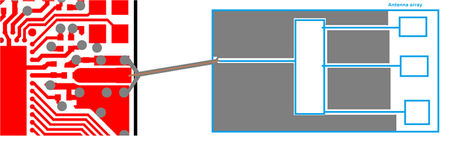

I need to connect an Antenna array to NRF52833 DK. Instead of using connectors in J1, can I take wire across the onboard Antenna. Will this solution work?

Placing the antenna cable across the PCB antenna will not work, unfortunately. You must use the J1 connector.

Thank you for your response. Instead can I remove the onboard chip antenna and then connect my external antenna to it?
In the antenna array side I have MCRF Coaxial connector.

The cost of connectors are high. so, I am finding an alternate way to connect both of them. Kindly provide me the best way to connect them.
To be sure that the connection works as it should the connectors are the best method.
Soldering on a coax at both ends is a solution, soldering the inner connector to the RF path on both sides and the surrounding conducting shield to ground.

I appreciate your fast response. Kindly eloborate the soldering solution suggested above. Thanks in advance.
a coax cable as the one listed in this datasheet can work.
Note: You must remove the connectors on the DK and antenna array and solder on the coax cable instead. Inner connector you solder to the RF path and surrounding conducting shield to ground.
This means that you will need to solder and desolder the connectors of you want to be able to use the connects or the DK as a DK with onboard antenna, so you loose the flexibility with this solution.
