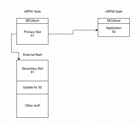

    SMP Client on the nRF9160
    I think it makes sense to have 1 of the nRF microcontrollers be a "DFU host".
    Then the other microcontroller just receives the DFU.
    As the nRF9160 has an external flash, I suggest that you use the nRF9160 as the DFU host.
    In that case, the flash layout would look like the following:
    Then you can run Serial Recovery on the nRF52.
    Since the nRF52811 has limited flash space available, I think Serial Recovery is a good idea.
    To write the updates from the nRF91 to the nRF52, you can run an SMP Client over UART on the nRF9160.
    The downside is that you have no official SMP Client over UART.
    you also do not have an unofficial SMP Client over UART yet.
    However, I am working on one at https://github.com/hellesvik-nordic/samples_for_nrf_connect_sdk/tree/main/bootloader_samples/client_smp/smp_client_uart.
    Next up you need to download the updates.
    Since the nRF9160 is the host, you can download images over LTE and save them to its external flash.
    I do not have a lot of experience with LTE, so I can not say exactly how, but I guess it would be similar to our Serial LTE Modem (SLM) FOTA.
    Headsup: I think that the SLM use the DFU Target library, which reads the header of a DFU package, and applies this to the application core if MCUboot is detected. You might need to implement something to make it detect MCUboot updates for the 52.

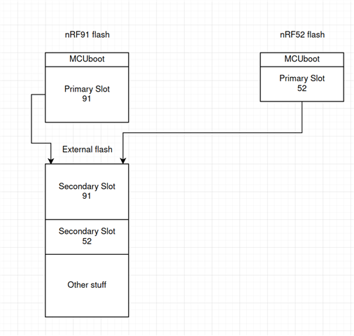

    Shared External Flash
    Depending on how you design your project, using a shared external flash as you suggest may be easier and better than my solution above.
    The main downside is that it requires changes to hardware: You need to connect the external flash to the nRF52811.
    I talked to a colleague about this, and he reported to have found that the nRF52810 has too little RAM for use with External Flash.
    Before you go for this solution, make sure to test the nRF52811 with an external flash, to find out if it is even possible!
    The software design is easier here, as MCUboot will have two slots for both the nRF52 and the nRF91: nRF52 Primary, nRF52 Secondary, nRF91 Primary and nRF91 Secondary:
    While booting, the respective nRFs will perform a software swap at startup if the secondary slots are tagged with "test".
    To receive a DFU image on the nRF52, you can run an SMP Server feat Bluetooth Low Energy.
    Headsup: When I build this sample for the nRF52840dk_nrf52811, I get errors due to too little flash. You likely have to do some Memory footprint optimization to make it work.
    But it would be a good idea to test this memory optimization before going for this solution.
    Images received in this way will be written to nRF52 secondary slot by default. Some custom handling is likely needed to make it write to nRF91 secondary slot instead.
    To receive a DFU image on the nRF91, I will say the same as for the other solution:
    The last part here would be to handle the External flash communication.
    I asked a colleague if two chips can use the same external flash, and he said:
    "You need to manage access to the flash, akin to flow control in UART communication as the two micros will have to share a bus where both acts as masters. Static partitions are probably needed. "
    In other words, it seems possible, but you have to handle external flash access.
    This would be a generic microcontroller challenge, so I am sure that you can find a lot of designs on how to do this on the internet.

    • SMP Client on the nRF9160:
      • The SMP Client over UART is not finished, you might have to write some of it yourself, depending on your timetables.
      • hci_uart for the nRF52811 limits the nRF52811 functionality
    • Shared External Flash:
      • The nRF52811 might not have enough RAM for External Flash
      • The nRF52811 might not have enough RAM for the SMP Server, which would limit DFU over Bluetooth LE-
      • The External flash needs to be routed in hardware
