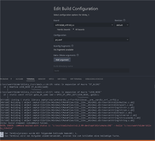

Building Blinky project gives me a linker error.
I was folowing the toturial on the DevAcademy nRF Connect SDK Fundamentals, where we would build a simple led blinky software.Everything was going well until we had to compile the program (it was almost too good to be true that it would work on the first try).
After examining the output of Cmake, I notice that some paths for the header and source files are missing as the linker could not resolve some symbols.

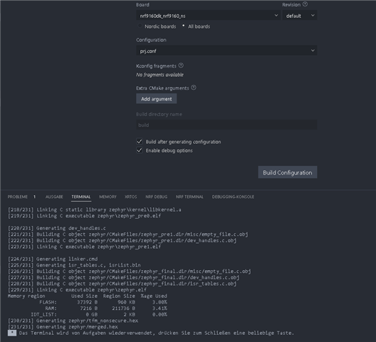

    After clicking around, I found the issue. I have picked the wrong build configuration. I took nrf9160dk_nrf52840 as my board in the build confguraion. However, after changing to nrf9160dk_nrf9160ns it finally resoved the symbols.
    Build configuration  nrf9160dk_nrf52840:
    Build configuration  nrf9160dk_nrf9160ns:
    Can some explain me why?
    For instance, the DT_ALIAS, which the Cmake does not find in image above, is general function for getting the node information. It should be working on every board, right?
