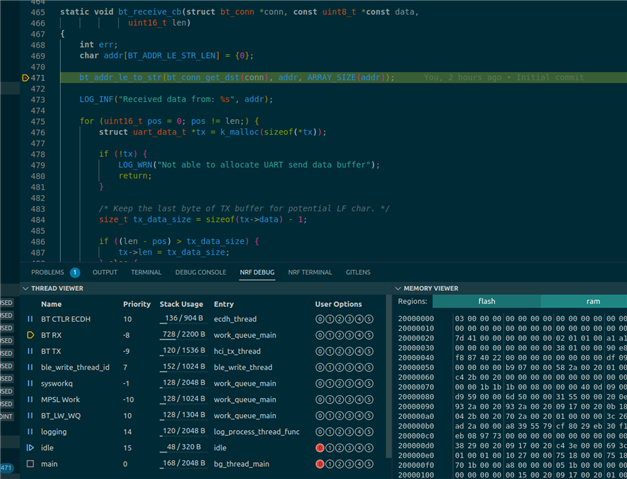

Most callbacks appear to be called from the System Workqueue.
HCI is the communication interface between the Bluetooth controller and host, so it is the Bluetooth host API you should be looking at.
yes. I understand It.
What I am concerned about is which thread (Context) is calling the callback when it is called back using the Bluetooth Host API.
I expect all callbacks to be called from SystemWorkq.

What thread/workqueue they are run in depends on your configuration settings here: https://github.com/nrfconnect/sdk-zephyr/blob/main/subsys/bluetooth/host/Kconfig#L97. You can open the thread viewer when debugging the application in VS code or Segger Ozone to confirm what thread a particular callback is run in.
E.g.
E.g.
