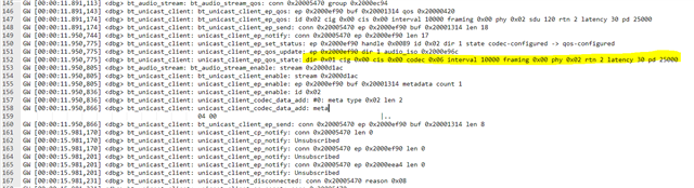

  • We are looking into this, can you add the following config in the gateway for getting more information?
    CONFIG_BT_AUDIO_DEBUG_UNICAST_CLIENT=y
    CONFIG_BT_AUDIO_STREAM_LOG_LEVEL_DBG=y
    CONFIG_LOG_BUFFER_SIZE=8192
    Kenneth
  • Hi Kenneth,
    Here is the log I get when trying to connect using a build of the 5340 application from version 2.2.99-dev3 with only the following changes in addition to the log flags you mentioned.
    • CONFIG_BT_AUDIO_PRESENTATION_DELAY_US=25000
    • CONFIG_BT_AUDIO_MAX_TRANSPORT_LATENCY_MS=30
    • Connecting to headphones based on their name.

    GW [00:00:11.891,113] <inf> cis_gateway: LEFT sink stream connected
    GW [00:00:11.891,113] <dbg> bt_audio_stream: bt_audio_stream_qos: conn 0x20005470 group 0x2000ec94
    GW [00:00:11.891,143] <dbg> bt_unicast_client: bt_unicast_client_ep_qos: ep 0x2000ef90 buf 0x20001314 qos 0x20000420
    GW [00:00:11.891,174] <dbg> bt_unicast_client: bt_unicast_client_ep_qos: id 0x02 cig 0x00 cis 0x00 interval 10000 framing 0x00 phy 0x02 sdu 120 rtn 2 latency 30 pd 25000
    GW [00:00:11.891,174] <dbg> bt_unicast_client: bt_unicast_client_ep_send: conn 0x20005470 ep 0x2000ef90 buf 0x20001314 len 18
    GW [00:00:11.950,744] <dbg> bt_unicast_client: unicast_client_ep_notify: conn 0x20005470 ep 0x2000ef90 len 17
    GW [00:00:11.950,775] <dbg> bt_unicast_client: unicast_client_ep_set_status: ep 0x2000ef90 handle 0x0089 id 0x02 dir 1 state codec-configured -> qos-configured
    GW [00:00:11.950,775] <dbg> bt_unicast_client: unicast_client_ep_qos_update: ep 0x2000ef90 dir 1 audio_iso 0x2000e96c
    GW [00:00:11.950,775] <dbg> bt_unicast_client: unicast_client_ep_qos_state: dir 0x01 cig 0x00 cis 0x00 codec 0x06 interval 10000 framing 0x00 phy 0x02 rtn 2 latency 30 pd 25000
    GW [00:00:11.950,805] <dbg> bt_audio_stream: bt_audio_stream_enable: stream 0x2000d1ac
    GW [00:00:11.950,805] <dbg> bt_unicast_client: bt_unicast_client_enable: stream 0x2000d1ac
    GW [00:00:11.950,805] <dbg> bt_unicast_client: unicast_client_ep_enable: ep 0x2000ef90 buf 0x20001314 metadata count 1
    GW [00:00:11.950,836] <dbg> bt_unicast_client: unicast_client_ep_enable: id 0x02
    GW [00:00:11.950,836] <dbg> bt_unicast_client: unicast_client_codec_data_add: #0: meta type 0x02 len 2
    GW [00:00:11.950,866] <dbg> bt_unicast_client: unicast_client_codec_data_add: meta
                                                   04 00                                            |..
    GW [00:00:11.950,866] <dbg> bt_unicast_client: bt_unicast_client_ep_send: conn 0x20005470 ep 0x2000ef90 buf 0x20001314 len 8
    GW [00:00:15.981,170] <dbg> bt_unicast_client: unicast_client_cp_notify: conn 0x20005470 len 0
    GW [00:00:15.981,170] <dbg> bt_unicast_client: unicast_client_cp_notify: Unsubscribed
    GW [00:00:15.981,170] <dbg> bt_unicast_client: unicast_client_ep_notify: conn 0x20005470 ep 0x2000ef90 len 0
    GW [00:00:15.981,201] <dbg> bt_unicast_client: unicast_client_ep_notify: Unsubscribed
    GW [00:00:15.981,201] <dbg> bt_unicast_client: unicast_client_ep_notify: conn 0x20005470 ep 0x2000eea4 len 0
    GW [00:00:15.981,231] <dbg> bt_unicast_client: unicast_client_disconnected: conn 0x20005470 reason 0x08
    GW [00:00:15.981,231] <dbg> bt_unicast_client: unicast_client_ep_reset: conn 0x20005470
    GW [00:00:15.981,231] <dbg> bt_unicast_client: unicast_client_reset: ep 0x2000eea4
    GW [00:00:15.981,262] <dbg> bt_audio_stream: bt_audio_stream_reset: stream (nil)
    GW [00:00:15.981,262] <dbg> bt_unicast_client: unicast_client_reset: ep 0x2000ef90
    GW [00:00:15.981,292] <dbg> bt_audio_stream: bt_audio_stream_reset: stream 0x2000d1ac
    GW [00:00:15.981,292] <dbg> bt_audio_stream: bt_audio_stream_detach: stream 0x2000d1ac
    GW [00:00:15.981,292] <dbg> bt_audio_stream: bt_audio_stream_disconnect: stream 0x2000d1ac iso (nil)
    GW [00:00:15.981,414] <inf> cis_gateway: Disconnected: 70:5A:6F:60:62:71 (public) (reason 0x08)

    GW [00:00:18.016,326] <wrn> bt_gatt: conn 0x20005470 err 0x0e
    GW [00:00:18.016,845] <dbg> bt_unicast_client: unicast_client_disconnected: conn 0x20005470 reason 0x16
    GW [00:00:18.016,876] <dbg> bt_unicast_client: unicast_client_ep_reset: conn 0x20005470
    GW [00:00:18.016,876] <dbg> bt_unicast_client: unicast_client_reset: ep 0x2000eea4
    GW [00:00:18.016,906] <dbg> bt_audio_stream: bt_audio_stream_reset: stream (nil)
    GW [00:00:18.016,906] <dbg> bt_unicast_client: unicast_client_reset: ep 0x2000ef90
    GW [00:00:18.016,998] <inf> cis_gateway: Disconnected: 70:5A:6F:60:62:71 (public) (reason 0x16)
    GW [00:00:18.016,998] <wrn> cis_gateway: Connection not found
    GW [00:00:18.017,028] <wrn> cis_gateway: Unknown connection
    GW [00:00:18.017,089] <dbg> cis_gateway: bond_check: Stored bonding found: 70:5A:6F:60:62:71 (public)
    GW [00:00:18.017,639] <inf> cis_gateway: Scanning successfully started
    GW [00:00:19.174,102] <inf> cis_gateway: Found Whitelisted Advertiser
    GW [00:00:19.311,676] <inf> cis_gateway: Connected: 70:5A:6F:60:62:71 (public)
    GW [00:00:19.511,932] <err> cis_gateway: Security failed: level 1 err 2
    GW [00:00:19.612,640] <wrn> bt_att: Not connected
    GW [00:00:19.612,670] <err> bt_conn: not connected!
    After the timeout, at ~15.9s the device then continuously finds and fails to pair to the headphones until I cycle both. I believe this is because the initial headphone that the gateway tries to enable the stream to asserts (it visibly seems to blink red and turn off while the other continues blinking for advertising) and the other one keeps advertising, but security fails because of (I'm guessing) some spec behaviour around pairing to the same address.
    I have also reported this to the headphone manufacturer, but as I noted they work with Android which makes it harder to dismiss the problem as only relevant to the headphone and not the 5340.
    Thanks
  • They are discussing this internally, but from the log it seems the headset is OK with the QoS setting, but suddenly headset disconnected. The reason is 0x08, which means headset stop sending any packets. Probably the issue is from headset side. Will let you know if I receive more feedback internally.
    Kenneth
  • Hi Kenneth,
    I've just been informed by the headphone manufacturer that their technical team has also encountered this problem when interfacing with certain devices and will be submitting a case with Qualcomm who must be supplying the LE Audio firmware component for the headphones.
    Once I receive an update on this issue I will try again, but for now I'm assuming this bug is completely due to the headphone side.
    Thanks for your help!
