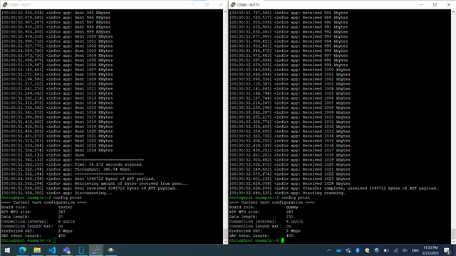

    I was tied up by another task last couple days. Now I compiled and downloaded both boards and I encountered some problems.
    On the tester board, I pushed the button 3 and I see this:
    throughput example:~$ config print
    ==== Current test configuration ====
    Board role: tester
    ATT MTU size: 247
    Data length: 27
    Connection interval: 6 units
    Connection length ext: on
    Preferred PHY: 2 Mbps
    GAP event length: 400
    On the dummy board, I pushed the button 4 and I see this:
    Board role: dummy
    ATT MTU size: 247
    Data length: 251
    The Data length are different. Do they need to be equal?
    When I type 'run', the dummy board complained:
    'Wrong board setup!'
    Do you have any suggestion?

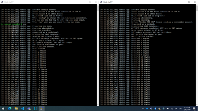

  • Welcome back vn2000,
    The Data Length doesn't seem to have to be equal.
    I reviewed the source code and see that the example would complain "Wrong board setup!" if you call run from the dummy/responder board.
    Please command "run" on the tester board.
    Here is my log for your reference.
  • Hello Hieu,
    I can make it work now. The only thing I have to set the data length to 251 on the tester. I don't know why it was not set to 251 as default like the dummy board. I can fix it in the firmware.
