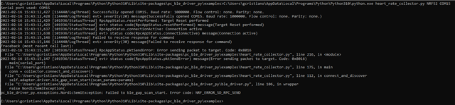

But then, I tried to exploit my dongle using the standard pc_ble_driver_py library on python (windows 10 OS), the last current version :
I tried at first to simply execute the heart_rate_collector.py example located in pc_ble_driver_py\examples directory. But then, a timeout error exception is being thrown, and I have trouble understanding why, I just followed the default steps.
Here's my trial :
I tried to look more carefully where was the error being thrown. Turns out that it comes from a function _nrf_ble_driver_sd_api_v5.sd_rpc_close(adapter) defined in the nrf-ble-driver-sd_api_v5-mt-4_1_4.dll file, and I can't look at it since it is compiled already...

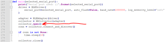

The problem happens at the following line of the heart_rate_collector.py program example, when I'm calling the open function of the library :

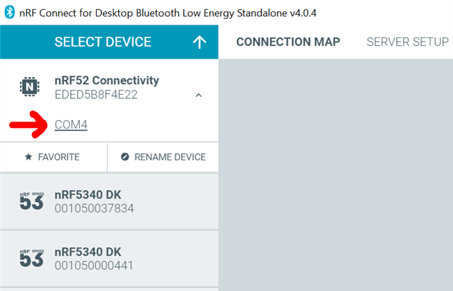

    About the connectivity FW I used, I tried multiple things. At first, I used the default configuration given with the nRF BLE app (see image below) :
    So I'm not exactly sure where to check what hex files it is concretely using. Do you know where I can check it ?
    But ! I do know that the heart_rate_collector.py example script is using the _nrf_ble_driver_sd_api_v5.pyd file in my case, so I suppose it is referring to the sd_api_v5 version folder of the hex files.
    I have this when opening the nRF Programmer app once the dongle is configured by default :
    At some point, because it was not working (getting the 'No response from device' message error), I did try to program it myself with the nRF Programmer app. I tried kind of randomly to use the hex files you can see in the image below.
    But I do not know exactly how it works. And so, it was not working as well (the example script), no matter the hex files, but there's a possibility I did it wrong.
    No matter what I did, it was not working. But shouldn't the default programmer be enough anyway ?
    On top of that, my colleague was able to make the same dongle work with the default configuration as well.

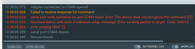

    When I try to execute directly the heart_rate_collector.py program example, I get the same error as before from my terminal (that I'm running in administrator mode on windows). Then I tried to see if I was able to at least scan with it directly on the nRF BLE app. But the dongle seems to be unstable there.
    Sometimes When I try to open it directly, I get the following message error :
    Sometimes I simply can't select my dongle, it disappears from the list, and I have to enter into programmer mode again to be able to use it again (which hex file is used at this point ? I'm not sure).
    Also sometimes I was able to select it (sometimes going into reset mode again), but the nRF BLE app is asking me to reprogram it. 2 different things from there : either I say yes and it is reprogramming indefinitely (so I have to plug out manually the dongle or close the nRF BLE app to stop it...), either I say yes and it successfully reprograms it, but it gives me the following output :
    I'm even more confused than at the beginning. Could you describe more precisely the steps you want me to do please next time so that I'm sure I'm giving you a good/accurate feedback ?
