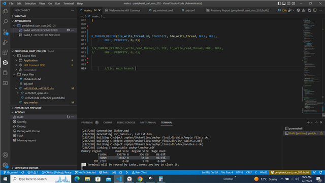

    I am using Vscode studio, NCS SDK 2.0.2, and a peripheral Uart example. I need some guidelines regarding SRAM size reduction for nrf52820. Without adding my own code into this example SRAM size is
SRAM:       32417 B        32 KB     98.93%

When I disabled the # Config logger part then code size was reduced to 3732 B . I need to reduce it at least 10 - 15kb

    I have not looked at the details of all your configurations, but the numbers seems to match a debug build. When I build the unmodified Bluetooth peripheral UART sample from SDK 2.0.2 with prj.conf I get this memory usage with debug optimizations enabled:
               FLASH:      257156 B       256 KB     98.10%
                SRAM:       31728 B        32 KB     96.83%
            IDT_LIST:          0 GB         2 KB      0.00%
    With minimal confiiguration (prj_minimal.conf) with debug I get this memory usage:
               FLASH:      157276 B       256 KB     60.00%
                SRAM:       21052 B        32 KB     64.25%
    And with minimal configuration and without debug I get this memory usage:
               FLASH:      138124 B       256 KB     52.69%
                SRAM:       20618 B        32 KB     62.92%
    So the first thing is to make sure you don't enable debug options. Also, in case it is not clear, you should not use prj.conf and prj_minimal.conf. If you want a minimal build, use just prj_minimal.conf.
