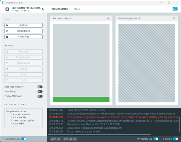

nRF52840-Dongle bricked on first program
Hardware:
nRF52840-Dongle
Utilities:
nRF Connect for Desktop v3.12.0 (Win10)
Programmer v3.0.4
sniffer_nrf52840dongle_nrf52840_4.1.1.hex
Plugged in Dongle and was properly recognized by the OS and within the Programmer tool and had the blinking Red light when plugged in.
Attempted first programming of nRF52840 Dongle using the sniffer_nrf52840dongle_nrf52840_4.1.1.hex file.
After uploading the image, the device memory could no longer be read.  There are no longer any lights on the dongle when plugging in.  Programmer identifies the device as 'UNKNOWN_FAMILY' and does not allow me to write any new hex files to the device.
I attempted all recovery solutions I could find on the forums:
Attempted pressing SW1 and then selecting the device in Programmer.  No change.
Pressing RESET disconnects the device in Programmer.  When re-connecting the same issue remains.
Tried holding RESET button while plugged in, or even while plugging in (power cycling) the dongle.  No change, and it does not show up as a USB drive so I cannot drop any bootloaders.
Attempted nrfjprog -f NRF52 --recover  in both Windows 10 CLI and Linux CLI.
ERROR: No debuggers were discovered.
NOTE: For additional output, try running again with logging enabled (--log).
NOTE: Any generated log error messages will be displayed.
Dongle is plugged directly into a PC USB port (no cables or hubs).
I do not have an external SEGGER/J-Link Device.  Are there any additional recovery steps I can perform, or corrected procedures to what I have already attempted?
Can anyone identify what I did wrong so that I don't bork my other dongle as well?
Logs from the original Write are attached, as well as a screenshot of the current Programmer UI.
Current Error logs when connecting to the device are below:

2023-02-07T06:23:08.383Z ERROR Error when fetching device versions: readFwInfo error (Origin: "Error when starting nrfdl_fw_read_info")

2023-02-07T04:59:54.071Z INFO All dfu images have been written to the target device
2023-02-07T04:59:54.073Z DEBUG Will wait for device C79371C19754
2023-02-07T04:59:54.225Z INFO Target device closed
2023-02-07T04:59:57.074Z DEBUG Timeout when waiting for attachment of device with serial number C79371C19754
2023-02-07T04:59:57.074Z ERROR Failed to write: Error: Timeout while waiting for device  C79371C19754 to be attached and enumerated
2023-02-07T05:02:45.969Z INFO Using @nordicsemiconductor/nrf-device-lib-js to communicate with target via USB SDFU protocol
2023-02-07T05:02:46.053Z ERROR Error when fetching device versions: readFwInfo error (Origin: "Error when starting nrfdl_fw_read_info")
2023-02-07T05:03:04.211Z INFO Target device closed
2023-02-07T05:03:12.672Z INFO Using @nordicsemiconductor/nrf-device-lib-js to communicate with target via USB SDFU protocol
2023-02-07T05:03:12.755Z ERROR Error when fetching device versions: readFwInfo error (Origin: "Error when starting nrfdl_fw_read_info")
2023-02-07T05:05:37.554Z INFO Target device closed
2023-02-07T05:05:40.072Z INFO Using @nordicsemiconductor/nrf-device-lib-js to communicate with target via USB SDFU protocol
2023-02-07T05:05:40.155Z ERROR Error when fetching device versions: readFwInfo error (Origin: "Error when starting nrfdl_fw_read_info")
Parents Reply
  • Thanks.  I didn't notice any clearly called-out steps in article itself that were able to resolve my situation, since the "Programmer" utility wouldn't recognize the dongle and I don't have a $400 programmer.  However, in the comments section I did just find the below nugget regarding the "Connect BLE" Utility and it somehow allowed me to recover the device.
    The nRF Connect Programmer will not destroy your dongle. But you need to re-flash it with the connectivity firmware that is used by pc-ble-driver. The easiest way to do this is to press the reset button so that it enters DFU mode, and then select the dongle in nRF Connect BLE. When you do it will ask you if it should flash the connectivity firmware.
