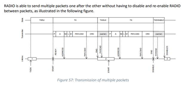

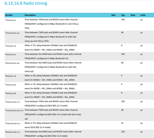

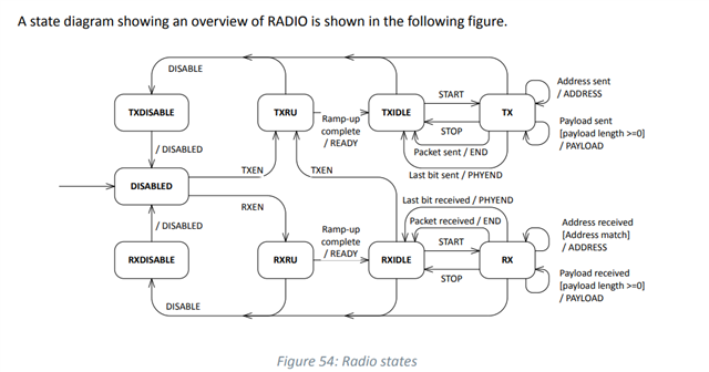

In summary, I know the retries are working because the receiver will see a delay of 220us if it picks up the first transmit and ignore the rest. However, it appears that several transmits cannot be received (or are never sent) because the receiver only gets subsequent transmissions at 420us, 620us, etc. If MAX_RETRIES or the delay after nrf_esb_write_payload() is too small, then the receiver either gets the first transaction or none at all. In previous iterations of this design, I have used an NRF24L01+ and, using the CE, have been able to produce much small delays between TX events to the receiver.
  1. Is there a way to minimize the delay between successful TX transactions?
  2. Based on Figure 54 (below left) and Section 6.12.16.8 (below middle) of https://infocenter.nordicsemi.com/pdf/nRF52820_PS_v1.3.pdf, I believe I'm running into an issue where the radio goes from TX to TXDISABLE to DISABLED to TXRU to TXIDLE to TX which causes these ~200us delays. However, I would like the device to operate as it does in Figure 57 (below right). What am I missing to make this happen?
Thank you for your help in advance. Please let me know if I can provide more information.
  • Hi Patrick
    A lot of the delay is down to the TX rampup, which by default is 130us in the nRF52 series in order to be compatible with the older devices.
    The nRF52 series does support a 40us 'fast' rampup option which allows you to power on the radio much faster, and I have included a modified version of the library below that enables this mode:
