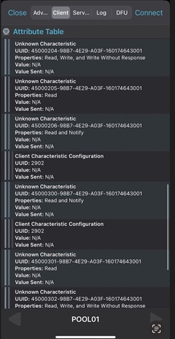

I am working on a project to build a custom BLE interface to a third-party peripheral device (a pool chlorinator / pump controller FWIW). I need to sniff the traffic between the third-party mobile app and the peripheral to reverse engineer the protocol and encryption type. However, when I sniff the connection process, there seems to be quite a lot of connection steps that are missing. In an effort to debug what's going on here, I've sniffed the connection from the nRF Connect mobile app (instead of the third-party app) to the peripheral, which successfully connects and retrieves a bunch of attributes. At least this way the encryption is taken out of the equation, as the nRF Connect app won't be able to negotiate the encryption (right?). It still seems like I'm not seeing all the packets.

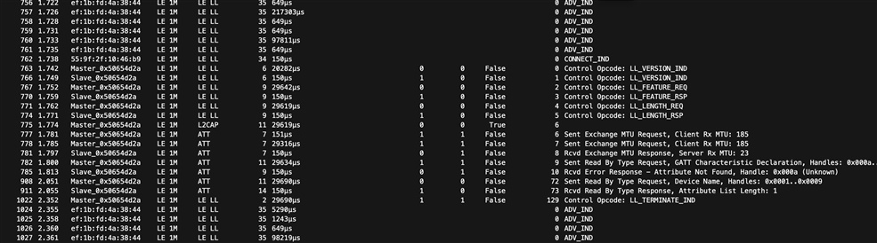

Using Wireshark, I have selected the particular peripheral device from the device list, and captured the traffic while I connect to the peripheral with the nRF Connect mobile app.
Here is what the comms look like in wireshark (I've filtered the empty packets):
Wireshark screencap
It appears that the sniffer is following the connection, but very little data is exchanged.

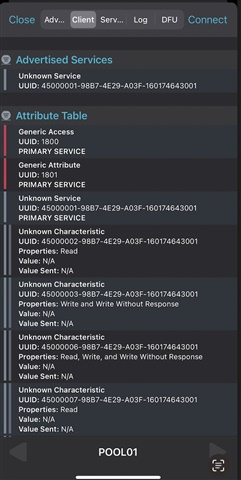

However, in nRF Connect, I get a long list of characteristics:
How does nRF Connect retrieve all these characteristics without seeing it in wireshark? Am I missing packets somehow?

  • Hi Paul,
    Could you send the sniffer trace where you captured the connection ?
    In many phones (including iPhone) , the phone would cache the attribute table and doesn't do service discovery on each connection.
    If you want to force a new service discovery you may need to turn off and on Bluetooth or restart the phone if that doesn't work.
    The phone cache the attribute table when you don't have "service changed" characteristic in the table.
