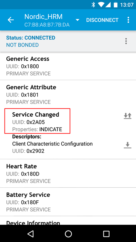

Generic Attribute Service (S110) is missing READ on Service Changed?
Hi
I've noticed that the Generic Attribute Service in profile code developed with S110 is missing the READ property on the Service Changed characteristic. It has INDICATE. The spec seems to say both READ and INDICATE are mandatory:
developer.bluetooth.org/.../ServiceViewer.aspx
Could someone clarify please?
Thank you
image description
