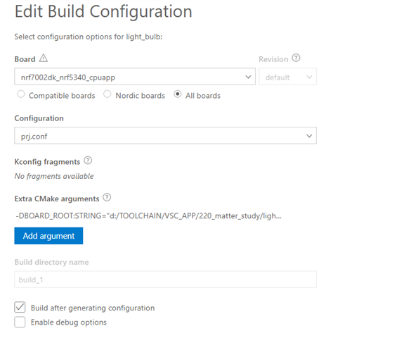

    3. At VS code, below was the configuration for ncs2.2.0  multiprotocol_rpms and ncs2.2.0 light bulb.

    I am not sure you are flashing the correct image to the network core. I would suggest you use the "west flash -d build" command.
    To be honest, I don't remember all the different files that go everywhere, but the network core image is found in build\hci_rpmsg\zephyr, not in the build\zephyr folder. "west flash" will do this autimatically (or if you flash from VS Code).
    So to the error message. I don't think the Wifi samples works in the v2.2.0 in NCS. I get the same error as you do. If you want to, you can try to use the main branch (which at some points in time may work, while other times can break), or you need to wait for the next stable release of ncs.
