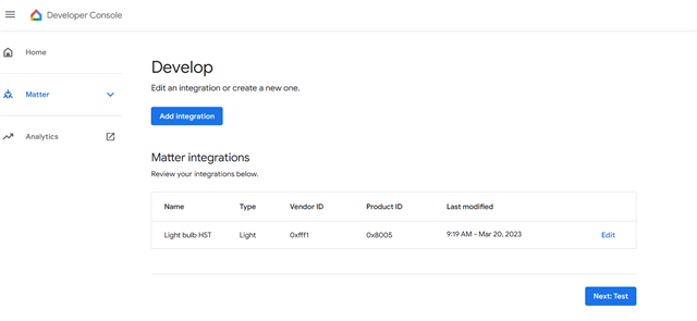

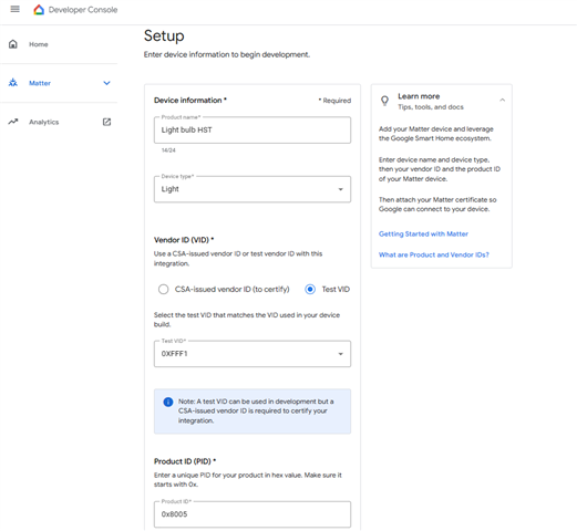

- Google Net hub 2 ()
- WiFi AP
- Latest Google home apps (2.63.1.12)  at smartphone (Samsung A52s, Android 13)

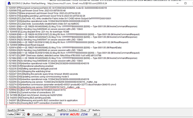

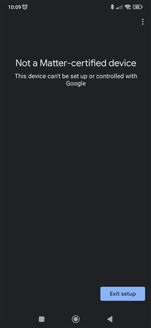

No matter which DK and which sample, commissioning always failed. Below was log information.

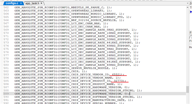

I: 429 [DIS]Advertise commission parameter vendorID=65521 productID=32773 discriminator=3840/15 cm=1

I: 534 [DL]  Vendor Id: 65521 (0xFFF1)
I: 538 [DL]  Product Id: 32773 (0x8005)

E: 141714 [DL]Long dispatch time: 1603 ms, for event type 16388

  • Hi AHaug
    Google home apps was updated from 2.63.1.12 to 2.65.1.6.
    I have tried new version if solving the commissioning issue.
    New version can find Matter device and start commissioning.
    It still terminate BLE connection but telling me the reason.
    The reason was the device was not Matter qualified (No authorized DAC).
    It was different to Samsung SmartThings. SmartThings allowed non Matter qualified device.
    Did Nordic or Matter provide developer with test purposed DAC/PAI/...?
    Thanks.

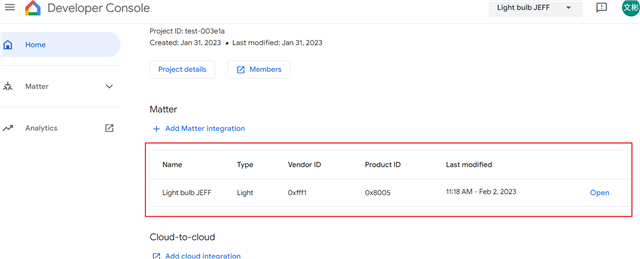

    The behaviour you're describing seems to be due to not adding the proper VID and PID to the dev console, so we're going back to my initial response to this case asking you to follow the blogpost devzone.nordicsemi.com/.../matter-testing-nrf-connect-sdk-platform-with-apple-google-and-samsung-ecosystems-218911247
    More specifically users needs to create a Google Developer account and Matter integration in order to commission non-certified devices: developers.home.google.com/.../create
    Apple, Amazon and Samsung do not have such requirement. In these ecosystems, we just got notification that device has not been certified - and so we need to click an "Approve" button.
    You state that you've added VID and PID to the developer console, so we have two questions:
    1. Which sample did you use and which VID/PID did you add to the console?
    2. Is the Google account the same for the phone, Hub and the developer console?
    Let me know about these two answers and we'll see if these two things are the reason for why it does not work.
    Andreas
  • Hi AHaug
    Did you try Google home ok?
    The sample I tried was ncs2.3.0 light bulb at NRF5340 DK. Actually, I also tried door lock/light switch/window covering/weather station. They also failed to commission at Google home.
    VID/PID is FFF1/8005. I didn't modify them at original sample code.
    I am sure added FFF1/8005 at my Google developer console as below.

    I: 499796 [DL]BLE connection established (ConnId: 0x00)
    I: 499801 [DL]Current number of connections: 1/1
    I: 499806 [DL]CHIPoBLE advertising stopped
    I: 499810 [DL]NFC Tag emulation stopped
    I: 500902 [BLE]local and remote recv window sizes = 5
    I: 500907 [BLE]selected BTP version 4
    I: 500910 [BLE]using BTP fragment sizes rx 128 / tx 128.
    D: 500925 [IN]BLE EndPoint 0x20012560 Connection Complete
    I: 500930 [DL]CHIPoBLE connection established (ConnId: 0x00, GATT MTU: 131)
    I: 501187 [EM]>>> [E:19809r M:39201373] (U) Msg RX from 0:F2EEF69C25EDE0D0 [0000] --- Type 0000:20 (SecureChannel:PBKDFParamRequest)
    I: 501200 [EM]<<< [E:19809r M:99810487] (U) Msg TX to 0:0000000000000000 [0000] --- Type 0000:21 (SecureChannel:PBKDFParamResponse)
    I: 501212 [IN](U) Sending msg 99810487 to IP address 'BLE'
    I: 501368 [EM]>>> [E:19809r M:39201374] (U) Msg RX from 0:F2EEF69C25EDE0D0 [0000] --- Type 0000:22 (SecureChannel:PASE_Pake1)
    I: 502899 [EM]<<< [E:19809r M:99810488] (U) Msg TX to 0:0000000000000000 [0000] --- Type 0000:23 (SecureChannel:PASE_Pake2)
    I: 502910 [IN](U) Sending msg 99810488 to IP address 'BLE'
    E: 502916 [DL]Long dispatch time: 1548 ms, for event type 16388
    I: 503078 [EM]>>> [E:19809r M:39201375] (U) Msg RX from 0:F2EEF69C25EDE0D0 [0000] --- Type 0000:24 (SecureChannel:PASE_Pake3)
    I: 503090 [EM]<<< [E:19809r M:99810489] (U) Msg TX to 0:0000000000000000 [0000] --- Type 0000:40 (SecureChannel:StatusReport)
    I: 503101 [IN](U) Sending msg 99810489 to IP address 'BLE'
    I: 503107 [SC]SecureSession[0x20004428]: Moving from state 'kEstablishing' --> 'kActive'
    D: 503115 [IN]SecureSession[0x20004428]: Activated - Type:1 LSID:13843
    D: 503121 [IN]New secure session activated for device <FFFFFFFB00000000, 0>, LSID:13843 PSID:25080!
    I: 503130 [SVR]Commissioning completed session establishment step
    I: 503136 [DIS]Updating services using commissioning mode 0
    I: 503142 [DIS]Advertise commission parameter vendorID=65521 productID=32773 discriminator=3840/15 cm=0
    E: 503152 [DIS]Failed to advertise extended commissionable node: 3
    D: 503157 [DIS]Scheduling extended discovery timeout in 900s
    E: 503163 [DIS]Failed to finalize service update: 1c
    I: 503168 [SVR]Device completed Rendezvous process
    I: 503174 [EM]>>> [E:19810r M:255810169] (S) Msg RX from 0:FFFFFFFB00000000 [0000] --- Type 0001:02 (IM:ReadRequest)
    D: 503184 [IM]Received Read request
    I: 503189 [EM]<<< [E:19810r M:64605829] (S) Msg TX to 0:FFFFFFFB00000000 [0000] --- Type 0001:05 (IM:ReportData)
    I: 503199 [IN](S) Sending msg 64605829 on secure session with LSID: 13843
    I: 503259 [EM]>>> [E:19811r M:255810170] (S) Msg RX from 0:FFFFFFFB00000000 [0000] --- Type 0001:02 (IM:ReadRequest)
    D: 503269 [IM]Received Read request
    I: 503274 [EM]<<< [E:19811r M:64605830] (S) Msg TX to 0:FFFFFFFB00000000 [0000] --- Type 0001:05 (IM:ReportData)
    I: 503284 [IN](S) Sending msg 64605830 on secure session with LSID: 13843
    I: 503349 [EM]>>> [E:19812r M:255810171] (S) Msg RX from 0:FFFFFFFB00000000 [0000] --- Type 0001:02 (IM:ReadRequest)
    D: 503359 [IM]Received Read request
    I: 503364 [EM]<<< [E:19812r M:64605831] (S) Msg TX to 0:FFFFFFFB00000000 [0000] --- Type 0001:05 (IM:ReportData)
    I: 503374 [IN](S) Sending msg 64605831 on secure session with LSID: 13843
    I: 503439 [EM]>>> [E:19813r M:255810172] (S) Msg RX from 0:FFFFFFFB00000000 [0000] --- Type 0001:02 (IM:ReadRequest)
    D: 503449 [IM]Received Read request
    I: 503454 [EM]<<< [E:19813r M:64605832] (S) Msg TX to 0:FFFFFFFB00000000 [0000] --- Type 0001:05 (IM:ReportData)
    I: 503464 [IN](S) Sending msg 64605832 on secure session with LSID: 13843
    I: 503529 [EM]>>> [E:19814r M:255810173] (S) Msg RX from 0:FFFFFFFB00000000 [0000] --- Type 0001:02 (IM:ReadRequest)
    D: 503539 [IM]Received Read request
    I: 503544 [EM]<<< [E:19814r M:64605833] (S) Msg TX to 0:FFFFFFFB00000000 [0000] --- Type 0001:05 (IM:ReportData)
    I: 503554 [IN](S) Sending msg 64605833 on secure session with LSID: 13843
    I: 503619 [EM]>>> [E:19815r M:255810174] (S) Msg RX from 0:FFFFFFFB00000000 [0000] --- Type 0001:02 (IM:ReadRequest)
    D: 503629 [IM]Received Read request
    I: 503636 [EM]<<< [E:19815r M:64605834] (S) Msg TX to 0:FFFFFFFB00000000 [0000] --- Type 0001:05 (IM:ReportData)
    I: 503646 [IN](S) Sending msg 64605834 on secure session with LSID: 13843
    I: 504068 [EM]>>> [E:19816r M:255810175] (S) Msg RX from 0:FFFFFFFB00000000 [0000] --- Type 0001:02 (IM:ReadRequest)
    D: 504078 [IM]Received Read request
    I: 504083 [EM]<<< [E:19816r M:64605835] (S) Msg TX to 0:FFFFFFFB00000000 [0000] --- Type 0001:05 (IM:ReportData)
    I: 504093 [IN](S) Sending msg 64605835 on secure session with LSID: 13843
    I: 514868 [EM]>>> [E:19817r M:255810176] (S) Msg RX from 0:FFFFFFFB00000000 [0000] --- Type 0001:0a (IM:TimedRequest)
    I: 514879 [EM]<<< [E:19817r M:64605836] (S) Msg TX to 0:FFFFFFFB00000000 [0000] --- Type 0001:01 (IM:StatusResponse)
    I: 514889 [IN](S) Sending msg 64605836 on secure session with LSID: 13843
    I: 514959 [EM]>>> [E:19817r M:255810177] (S) Msg RX from 0:FFFFFFFB00000000 [0000] --- Type 0001:08 (IM:InvokeCommandRequest)
    I: 514971 [FS]GeneralCommissioning: Received ArmFailSafe (120s)
    I: 514977 [EM]<<< [E:19817r M:64605837] (S) Msg TX to 0:FFFFFFFB00000000 [0000] --- Type 0001:09 (IM:InvokeCommandResponse)
    I: 514988 [IN](S) Sending msg 64605837 on secure session with LSID: 13843
    I: 515049 [EM]>>> [E:19818r M:255810178] (S) Msg RX from 0:FFFFFFFB00000000 [0000] --- Type 0001:02 (IM:ReadRequest)
    D: 515059 [IM]Received Read request
    I: 515064 [EM]<<< [E:19818r M:64605838] (S) Msg TX to 0:FFFFFFFB00000000 [0000] --- Type 0001:05 (IM:ReportData)
    I: 515074 [IN](S) Sending msg 64605838 on secure session with LSID: 13843
    I: 515139 [EM]>>> [E:19819r M:255810179] (S) Msg RX from 0:FFFFFFFB00000000 [0000] --- Type 0001:0a (IM:TimedRequest)
    I: 515150 [EM]<<< [E:19819r M:64605839] (S) Msg TX to 0:FFFFFFFB00000000 [0000] --- Type 0001:01 (IM:StatusResponse)
    I: 515160 [IN](S) Sending msg 64605839 on secure session with LSID: 13843
    I: 515229 [EM]>>> [E:19819r M:255810180] (S) Msg RX from 0:FFFFFFFB00000000 [0000] --- Type 0001:08 (IM:InvokeCommandRequest)
    I: 515245 [EM]<<< [E:19819r M:64605840] (S) Msg TX to 0:FFFFFFFB00000000 [0000] --- Type 0001:09 (IM:InvokeCommandResponse)
    I: 515256 [IN](S) Sending msg 64605840 on secure session with LSID: 13843
    I: 515319 [EM]>>> [E:19820r M:255810181] (S) Msg RX from 0:FFFFFFFB00000000 [0000] --- Type 0001:08 (IM:InvokeCommandRequest)
    I: 515330 [ZCL]OpCreds: Certificate Chain request received for DAC
    I: 515340 [EM]<<< [E:19820r M:64605841] (S) Msg TX to 0:FFFFFFFB00000000 [0000] --- Type 0001:09 (IM:InvokeCommandResponse)
    I: 515350 [IN](S) Sending msg 64605841 on secure session with LSID: 13843
    I: 515769 [EM]>>> [E:19821r M:255810182] (S) Msg RX from 0:FFFFFFFB00000000 [0000] --- Type 0001:08 (IM:InvokeCommandRequest)
    I: 515780 [ZCL]OpCreds: Certificate Chain request received for PAI
    I: 515789 [EM]<<< [E:19821r M:64605842] (S) Msg TX to 0:FFFFFFFB00000000 [0000] --- Type 0001:09 (IM:InvokeCommandResponse)
    I: 515800 [IN](S) Sending msg 64605842 on secure session with LSID: 13843
    I: 516219 [EM]>>> [E:19822r M:255810183] (S) Msg RX from 0:FFFFFFFB00000000 [0000] --- Type 0001:08 (IM:InvokeCommandRequest)
    I: 516231 [ZCL]OpCreds: Received an AttestationRequest command
    I: 516266 [ZCL]OpCreds: AttestationRequest successful.
    I: 516275 [EM]<<< [E:19822r M:64605843] (S) Msg TX to 0:FFFFFFFB00000000 [0000] --- Type 0001:09 (IM:InvokeCommandResponse)
    I: 516285 [IN](S) Sending msg 64605843 on secure session with LSID: 13843
    I: 516804 [EM]>>> [E:19823r M:255810184] (S) Msg RX from 0:FFFFFFFB00000000 [0000] --- Type 0001:08 (IM:InvokeCommandRequest)
    I: 516816 [ZCL]OpCreds: Received a CSRRequest command
    I: 516978 [ZCL]OpCreds: AllocatePendingOperationalKey succeeded
    I: 517013 [ZCL]OpCreds: CSRRequest successful.
    I: 517019 [EM]<<< [E:19823r M:64605844] (S) Msg TX to 0:FFFFFFFB00000000 [0000] --- Type 0001:09 (IM:InvokeCommandResponse)
    I: 517030 [IN](S) Sending msg 64605844 on secure session with LSID: 13843
    E: 517037 [DL]Long dispatch time: 234 ms, for event type 16388
    I: 519821 [EM]>>> [E:19824r M:255810185] (S) Msg RX from 0:FFFFFFFB00000000 [0000] --- Type 0001:08 (IM:InvokeCommandRequest)
    I: 519832 [ZCL]OpCreds: Received an AddTrustedRootCertificate command
    I: 519893 [ZCL]OpCreds: AddTrustedRootCertificate successful.
    I: 519899 [EM]<<< [E:19824r M:64605845] (S) Msg TX to 0:FFFFFFFB00000000 [0000] --- Type 0001:09 (IM:InvokeCommandResponse)
    I: 519911 [IN](S) Sending msg 64605845 on secure session with LSID: 13843
    I: 520452 [EM]>>> [E:19825r M:255810186] (S) Msg RX from 0:FFFFFFFB00000000 [0000] --- Type 0001:08 (IM:InvokeCommandRequest)
    I: 520463 [ZCL]OpCreds: Received an AddNOC command
    I: 520470 [FP]Validating NOC chain
    I: 520583 [FP]NOC chain validation successful
    I: 520587 [FP]Added new fabric at index: 0x1
    I: 520591 [FP]Assigned compressed fabric ID: 0x1C094C8A23038269, node ID: 0x00000000EA5A9319
    I: 520599 [TS]Last Known Good Time: 2023-03-08T09:50:48
    I: 520604 [TS]New proposed Last Known Good Time: 2023-03-20T04:02:26
    I: 520610 [TS]Updating pending Last Known Good Time to 2023-03-20T04:02:26
    I: 520628 [ZCL]OpCreds: ACL entry created for Fabric index 0x1 CASE Admin Subject 0xFFFFFFFD00010001
    I: 520637 [DIS]Advertise operational node 1C094C8A23038269-00000000EA5A9319
    I: 520644 [ZCL]OpCreds: successfully created fabric index 0x1 via AddNOC
    I: 520651 [EM]<<< [E:19825r M:64605846] (S) Msg TX to 1:FFFFFFFB00000000 [8269] --- Type 0001:09 (IM:InvokeCommandResponse)
    I: 520662 [IN](S) Sending msg 64605846 on secure session with LSID: 13843
    E: 520669 [DL]Long dispatch time: 221 ms, for event type 16388
    I: 520809 [EM]>>> [E:19826r M:255810187] (S) Msg RX from 1:FFFFFFFB00000000 [8269] --- Type 0001:08 (IM:InvokeCommandRequest)
    I: 520824 [EM]<<< [E:19826r M:64605847] (S) Msg TX to 1:FFFFFFFB00000000 [8269] --- Type 0001:09 (IM:InvokeCommandResponse)
    I: 520835 [IN](S) Sending msg 64605847 on secure session with LSID: 13843
    I: 520899 [EM]>>> [E:19827r M:255810188] (S) Msg RX from 1:FFFFFFFB00000000 [8269] --- Type 0001:02 (IM:ReadRequest)
    D: 520909 [IM]Received Read request
    I: 520914 [EM]<<< [E:19827r M:64605848] (S) Msg TX to 1:FFFFFFFB00000000 [8269] --- Type 0001:05 (IM:ReportData)
    I: 520924 [IN](S) Sending msg 64605848 on secure session with LSID: 13843
    I: 520989 [EM]>>> [E:19828r M:255810189] (S) Msg RX from 1:FFFFFFFB00000000 [8269] --- Type 0001:08 (IM:InvokeCommandRequest)
    I: 521873 [DL]SRP Client was started, detected server: fd4a:66ba:47f8:0000:1cd1:e6f2:d913:6798
    I: 521884 [EM]<<< [E:19828r M:64605849] (S) Msg TX to 1:FFFFFFFB00000000 [8269] --- Type 0001:09 (IM:InvokeCommandResponse)
    I: 521895 [IN](S) Sending msg 64605849 on secure session with LSID: 13843
    I: 521902 [DIS]Advertise operational node 1C094C8A23038269-00000000EA5A9319
    I: 521909 [SVR]Operational advertising enabled
    I: 522235 [DIS]Setting operational delegate post init
    I: 522243 [SWU]Stopping the watchdog timer
    I: 522247 [SWU]Starting the periodic query timer, timeout: 86400 seconds
    I: 522254 [DIS]Updating services using commissioning mode 0
    I: 522259 [DIS]Advertise operational node 1C094C8A23038269-00000000EA5A9319
    I: 522266 [DL]advertising srp service: 1C094C8A23038269-00000000EA5A9319._matter._tcp
    I: 522274 [DIS]Advertise commission parameter vendorID=65521 productID=32773 discriminator=3840/15 cm=0
    I: 522284 [DL]advertising srp service: D097CD20915C1AC3._matterc._udp
    I: 529942 [DL]BLE GAP connection terminated (reason 0x13)
    I: 529948 [DL]Current number of connections: 0/1
    E: 541998 [BLE]ack recv timeout, closing ep 0x20012560
    D: 542003 [IN]Clearing BLE pending packets.
    I: 542007 [BLE]Releasing end point's BLE connection back to application.
    I: 542014 [DL]Closing BLE GATT connection (ConnId 00)

  • Hi Carlie,
      When the light_switch demo (using latest 2.3.0) advertises itself, it then appears on my Android phone. I open the QR Code link and use my phone to read it. It then spends 30s doing it's Google Home stuff, trying to connect and I can see in the light_switch logs, that it attempts to register itselt on the Google device, then it displays the message Not a Matter Certified Device, as per attached screenshot.
    I'll try factory resetting it and will see if that helps.
