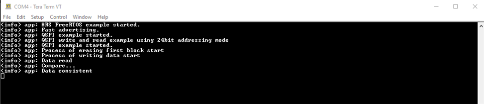

We use QSPI to operate the flash while ble is broadcasting. our software testers tested probabilistic reboots due to SOFTDEVICE: ASSERTION FAILED, pc = 0x0001786a or SOFTDEVICE: ASSERTION FAILED, pc = 0x00015074 or SOFTDEVICE: ASSERTION FAILED, pc = 0x00015a98. I read in the forum that RTOS turn off interrupts cannot turn off BLE interrupts and have done so, but the problem still occurs. when I write flash tests at 100ms, it goes to SOFTDEVICE in about 5 minutes: ASSERTION FAILED error.

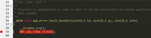

Printing does not seem to refresh, only the beginning of the time there is printing, I do not know why it does not print the log later. you can also debug when playing a breakpoint here, 15 minutes later to see if it will run to the 'app_error_fault_handler ()' function.
