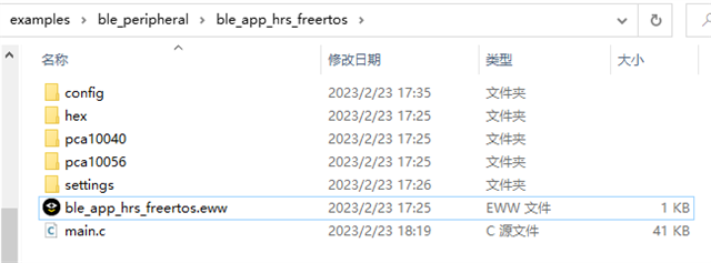

I uploaded my entire code repository, you can check the commit log of the git repository to see my changes. git repository's first commit is the official SDK, the second commit is the one I measured this problem. i used 'IAR EW for Arm 9.20.1' to open the IAR project path as shown in the picture.
