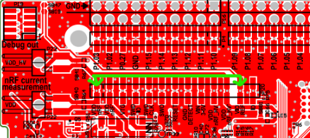

Recently however, we ran into an issue on the nrf5340 documented here. As a consequence, we added a short between VDD_nRF and VIO_REF in order to measure 4uA in low power modem (System off).

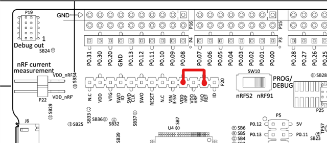

On the nrf9160, we also shorted VDD_nRF and VIO_REF so that we can run the entire board at 3.6V. We also flipped SW9 in the 3V position.

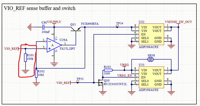

However, with the short on the nrf9160 in, we measure 40uA in the system off low power mode, instead of the expected 4uA. When we remove the short, we measure 4uA as expected. If the short is removed however, the board is running at 3V and we need to board running at 3.6V. Can you please advise which setup to use as to ensure that we get an accurate power measurement?

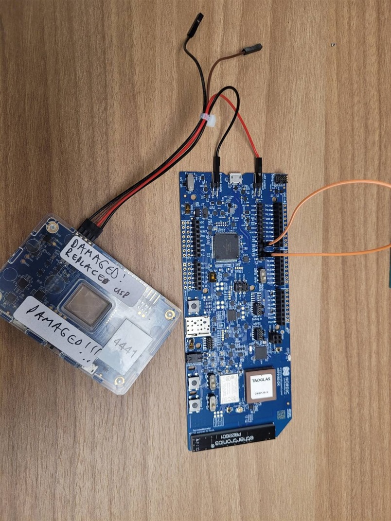

  • We are measuring the current in source meter mode at a 3.6V, connecting it to P22 and ground (see picture), and we short VDD_nRF and VIO_REF, so indeed we are using VDD_nRF as the source for VIO_REF. Not illustrated in the picture, as that we leave the USB cable connected, and flip the IFMCU DISCONN switch so that the interface MCU is offline.
    We dont really understand why on the one devkit (nrf5340) it is required to short the pin, and then on the nrf9160 it is not.
