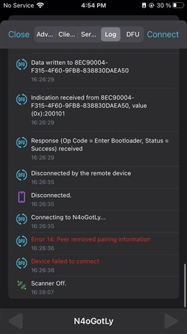

However, since I added that new variable, every attempt to do DFU is failing, even by deleting bond information + restarting the Bluetooth module in the phone, it's always showing me these logs in the nrf connect app (android and iOS).

    That's what I mean when I say "I added a variable". And I am currently testing to replicate as much scenarios as possible to recover the FW from DFU to a downgraded version. I can see that the problem resides in the firmware running in the device itself, not the build being downloaded, but I am not understanding what's the real issue that's making fail all the attempts to do DFU, even to versions which share the same property (the new variable in the struct).
    as an update, I see now that if I forget the device from the iphone I have running nrf connect, and restarting the bluetooth in the phone, the error I keep seeing in the logs from nrf connect is what I attached to this post "Error 14: Peer removed pairing information".
    If you forget the device on the phone, you also need to clear the bond information on the device. The central (phone) will not be able to pair to the peripheral if the peripheral still remembers the old bond.
