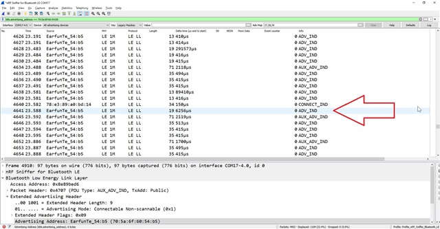

nRF5340 Audio DK Gateway Question
I paired nRF5340 audio DK gateway with Earfun Air Pro 3 earbuds. I found the gateway went through stream_configured, stream_qos_set, and stream enable more than Samsung Galaxy Buds2 Pro (Missing Forum Thread)
1) However, bt_unicast_client with handle 0x008c complained about "No space left to parse ASE". I am not sure why there are 3 handles: 0x0086, 0x0089 and 0x008c.
2) The other issue is "bt_conn: Found valid connection in connected state".

uart:~$ GW [00:00:10.592,926] <dbg> cis_gateway: device_found: Device found
GW [00:00:10.593,536] <wrn> bt_conn: Found valid connection in connected state
GW [00:00:10.593,536] <err> bt_conn: bt_conn_le_create - bt_conn_exists_le
GW [00:00:10.593,536] <err> cis_gateway: Could not init connection, ret: -22

GW [00:00:12.465,728] <wrn> bt_gatt: conn 0x20005138 err 0x0e
GW [00:00:12.467,529] <inf> bt_audio_stream: stream (nil)
GW [00:00:12.467,559] <inf> bt_audio_stream: stream (nil)
GW [00:00:12.467,651] <inf> cis_gateway: Disconnected: 70:5A:6F:60:54:B5 (public) (reason 0x16)
GW [00:00:12.467,651] <wrn> cis_gateway: Connection not found
GW [00:00:12.467,651] <wrn> cis_gateway: Unknown connection
GW [00:00:12.467,681] <inf> cis_gateway: ble_acl_start_scan
GW [00:00:12.467,681] <inf> bt_keys: bt_foreach_bond
uart:~$ GW [00:00:12.467,742] <dbg> cis_gateway: bond_check: Stored bonding found: 70:5A:6F:60:54:B5 (public)
GW [00:00:12.467,742] <inf> bt_scan: bt_le_scan_start
GW [00:00:12.468,414] <inf> cis_gateway: Scanning successfully started
GW [00:00:12.666,992] <dbg> cis_gateway: device_found: Device found
GW [00:00:12.667,602] <inf> bt_conn: conn: 20005138 id: 0 handle: 0 role: 0 type: 1 disconnected -> connecting
GW [00:00:12.667,602] <inf> bt_conn: addr: 0:0:0:0:0:0
GW [00:00:12.787,872] <inf> bt_conn: conn: 20005138 id: 0 handle: 0 role: 0 type: 1 connecting -> connected
GW [00:00:12.787,872] <inf> bt_conn: addr: 62:d2:25:70:cd:59
GW [00:00:12.791,229] <inf> cis_gateway: Connected: 70:5A:6F:60:54:B5 (public)
uart:~$ GW [00:00:12.989,471] <inf> cis_gateway: security_changed_cb
GW [00:00:12.989,471] <err> cis_gateway: Security failed: level 1 err 2
GW [00:00:12.989,685] <inf> bt_conn: conn: 20005138 id: 0 handle: 0 role: 0 type: 1 connected -> disconnecting
GW [00:00:12.989,685] <inf> bt_conn: addr: 62:d2:25:70:cd:59
GW [00:00:13.090,087] <wrn> bt_att: Not connected
GW [00:00:13.090,118] <err> bt_conn: not connected!
GW [00:00:13.091,217] <inf> bt_conn: conn: 20005138 id: 0 handle: 0 role: 0 type: 1 disconnecting -> disconnect-complete
GW [00:00:13.091,400] <inf> bt_conn: addr: 62:d2:25:70:cd:59
GW [00:00:13.091,430] <inf> bt_conn: conn: 20005138 id: 0 handle: 0 role: 0 type: 1 disconnect-complete -> disconnected
GW [00:00:13.091,430] <inf> bt_conn: addr: 62:d2:25:70:cd:59
GW [00:00:13.091,552] <wrn> bt_gatt: conn 0x20005138 err 0x0e
GW [00:00:13.093,353] <inf> bt_audio_stream: stream (nil)
uart:~$ GW [00:00:13.093,353] <inf> bt_audio_stream: stream (nil)
GW [00:00:13.093,383] <inf> bt_audio_stream: stream (nil)
GW [00:00:13.093,444] <inf> cis_gateway: Disconnected: 70:5A:6F:60:54:B5 (public) (reason 0x16)
GW [00:00:13.093,475] <wrn> cis_gateway: Connection not found
GW [00:00:13.093,475] <wrn> cis_gateway: Unknown connection
GW [00:00:13.093,475] <inf> cis_gateway: ble_acl_start_scan
GW [00:00:13.093,475] <inf> bt_keys: bt_foreach_bond
GW [00:00:13.093,536] <dbg> cis_gateway: bond_check: Stored bonding found: 70:5A:6F:60:54:B5 (public)
GW [00:00:13.093,566] <inf> bt_scan: bt_le_scan_start
GW [00:00:13.094,177] <inf> cis_gateway: Scanning successfully started
GW [00:00:13.286,804] <dbg> cis_gateway: device_found: Device found
GW [00:00:13.287,506] <inf> bt_conn: conn: 20005138 id: 0 handle: 0 role: 0 type: 1 disconnected -> connecting
GW [00:00:13.287,506] <inf> bt_conn: addr: 0:0:0:0:0:0
GW [00:00:13.362,548] <inf> bt_conn: conn: 20005138 id: 0 handle: 0 role: 0 type: 1 connecting -> connected
uart:~$ GW [00:00:13.362,548] <inf> bt_conn: addr: 62:d2:25:70:cd:59
GW [00:00:13.365,875] <inf> cis_gateway: Connected: 70:5A:6F:60:54:B5 (public)
GW [00:00:13.565,582] <inf> cis_gateway: security_changed_cb
GW [00:00:13.565,612] <err> cis_gateway: Security failed: level 1 err 2
GW [00:00:13.565,795] <inf> bt_conn: conn: 20005138 id: 0 handle: 0 role: 0 type: 1 connected -> disconnecting
GW [00:00:13.565,826] <inf> bt_conn: addr: 62:d2:25:70:cd:59
uart:~$ GW [00:00:13.666,656] <inf> bt_conn: conn: 20005138 id: 0 handle: 0 role: 0 type: 1 disconnecting -> disconnect-complete
GW [00:00:13.666,656] <inf> bt_conn: addr: 62:d2:25:70:cd:59
GW [00:00:13.666,687] <inf> bt_conn: conn: 20005138 id: 0 handle: 0 role: 0 type: 1 disconnect-complete -> disconnected
GW [00:00:13.666,687] <inf> bt_conn: addr: 62:d2:25:70:cd:59
GW [00:00:13.668,579] <inf> bt_audio_stream: stream (nil)
GW [00:00:13.668,609] <inf> bt_audio_stream: stream (nil)
GW [00:00:13.668,701] <inf> cis_gateway: Disconnected: 70:5A:6F:60:54:B5 (public) (reason 0x16)
GW [00:00:13.668,701] <wrn> cis_gateway: Connection not found
GW [00:00:13.668,701] <wrn> cis_gateway: Unknown connection
GW [00:00:13.668,731] <inf> cis_gateway: ble_acl_start_scan
GW [00:00:13.668,731] <inf> bt_keys: bt_foreach_bond
GW [00:00:13.668,792] <dbg> cis_gateway: bond_check: Stored bonding found: 70:5A:6F:60:54:B5 (public)
uart:~$ GW [00:00:13.668,823] <inf> bt_scan: bt_le_scan_start
GW [00:00:13.669,494] <inf> cis_gateway: Scanning successfully started
GW [00:00:13.753,112] <dbg> cis_gateway: device_found: Device found
GW [00:00:13.753,723] <inf> bt_conn: conn: 20005138 id: 0 handle: 0 role: 0 type: 1 disconnected -> connecting
GW [00:00:13.753,723] <inf> bt_conn: addr: 0:0:0:0:0:0
GW [00:00:13.755,920] <inf> bt_conn: conn: 20005138 id: 0 handle: 0 role: 0 type: 1 connecting -> connected
GW [00:00:13.755,950] <inf> bt_conn: addr: 62:d2:25:70:cd:59
GW [00:00:13.759,277] <inf> cis_gateway: Connected: 70:5A:6F:60:54:B5 (public)
GW [00:00:13.958,068] <inf> cis_gateway: security_changed_cb
GW [00:00:13.958,099] <err> cis_gateway: Security failed: level 1 err 2
GW [00:00:13.958,465] <inf> bt_conn: conn: 20005138 id: 0 handle: 0 role: 0 type: 1 connected -> disconnecting
GW [00:00:13.958,496] <inf> bt_conn: addr: 62:d2:25:70:cd:59
uart:~$ GW [00:00:14.058,135] <wrn> bt_att: Not connected
GW [00:00:14.058,197] <err> bt_conn: not connected!
GW [00:00:14.059,265] <inf> bt_conn: conn: 20005138 id: 0 handle: 0 role: 0 type: 1 disconnecting -> disconnect-complete
GW [00:00:14.059,265] <inf> bt_conn: addr: 62:d2:25:70:cd:59
GW [00:00:14.059,326] <inf> bt_conn: conn: 20005138 id: 0 handle: 0 role: 0 type: 1 disconnect-complete -> disconnected
GW [00:00:14.059,326] <inf> bt_conn: addr: 62:d2:25:70:cd:59
GW [00:00:14.059,570] <wrn> bt_gatt: conn 0x20005138 err 0x0e
GW [00:00:14.061,370] <inf> bt_audio_stream: stream (nil)
GW [00:00:14.061,401] <inf> bt_audio_stream: stream (nil)
GW [00:00:14.061,462] <inf> cis_gateway: Disconnected: 70:5A:6F:60:54:B5 (public) (reason 0x16)
GW [00:00:14.061,492] <wrn> cis_gateway: Connection not found
GW [00:00:14.061,492] <wrn> cis_gateway: Unknown connection
GW [00:00:14.061,492] <inf> cis_gateway: ble_acl_start_scan
uart:~$ GW [00:00:14.061,523] <inf> bt_keys: bt_foreach_bond
GW [00:00:14.061,584] <dbg> cis_gateway: bond_check: Stored bonding found: 70:5A:6F:60:54:B5 (public)
GW [00:00:14.061,584] <inf> bt_scan: bt_le_scan_start
GW [00:00:14.062,194] <inf> cis_gateway: Scanning successfully started
GW [00:00:14.254,974] <dbg> cis_gateway: device_found: Device found
GW [00:00:14.255,584] <inf> bt_conn: conn: 20005138 id: 0 handle: 0 role: 0 type: 1 disconnected -> connecting
GW [00:00:14.255,584] <inf> bt_conn: addr: 0:0:0:0:0:0
GW [00:00:14.260,131] <inf> bt_conn: conn: 20005138 id: 0 handle: 0 role: 0 type: 1 connecting -> connected
GW [00:00:14.260,131] <inf> bt_conn: addr: 62:d2:25:70:cd:59
GW [00:00:14.263,488] <inf> cis_gateway: Connected: 70:5A:6F:60:54:B5 (public)
GW [00:00:14.461,730] <inf> cis_gateway: security_changed_cb
GW [00:00:14.461,730] <err> cis_gateway: Security failed: level 1 err 2
GW [00:00:14.461,944] <inf> bt_conn: conn: 20005138 id: 0 handle: 0 role: 0 type: 1 connected -> disconnecting
uart:~$ GW [00:00:14.461,944] <inf> bt_conn: addr: 62:d2:25:70:cd:59
GW [00:00:14.562,500] <wrn> bt_att: Not connected
GW [00:00:14.562,530] <err> bt_conn: not connected!
GW [00:00:14.563,537] <inf> bt_conn: conn: 20005138 id: 0 handle: 0 role: 0 type: 1 disconnecting -> disconnect-complete
GW [00:00:14.563,537] <inf> bt_conn: addr: 62:d2:25:70:cd:59
GW [00:00:14.563,568] <inf> bt_conn: conn: 20005138 id: 0 handle: 0 role: 0 type: 1 disconnect-complete -> disconnected
GW [00:00:14.563,598] <inf> bt_conn: addr: 62:d2:25:70:cd:59
GW [00:00:14.563,690] <wrn> bt_gatt: conn 0x20005138 err 0x0e
GW [00:00:14.565,521] <inf> bt_audio_stream: stream (nil)
GW [00:00:14.565,551] <inf> bt_audio_stream: stream (nil)
GW [00:00:14.565,612] <inf> cis_gateway: Disconnected: 70:5A:6F:60:54:B5 (public) (reason 0x16)

uart:~$ GW [00:00:14.565,643] <wrn> cis_gateway: Connection not found
GW [00:00:14.565,643] <wrn> cis_gateway: Unknown connection
GW [00:00:14.565,643] <inf> cis_gateway: ble_acl_start_scan
GW [00:00:14.565,643] <inf> bt_keys: bt_foreach_bond
GW [00:00:14.565,734] <dbg> cis_gateway: bond_check: Stored bonding found: 70:5A:6F:60:54:B5 (public)
GW [00:00:14.565,734] <inf> bt_scan: bt_le_scan_start
GW [00:00:14.566,528] <inf> cis_gateway: Scanning successfully started
GW [00:00:14.653,533] <dbg> cis_gateway: device_found: Device found
GW [00:00:14.653,991] <inf> bt_conn: conn: 20005138 id: 0 handle: 0 role: 0 type: 1 disconnected -> connecting
GW [00:00:14.654,022] <inf> bt_conn: addr: 0:0:0:0:0:0
GW [00:00:14.662,597] <inf> bt_conn: conn: 20005138 id: 0 handle: 0 role: 0 type: 1 connecting -> connected
GW [00:00:14.662,597] <inf> bt_conn: addr: 62:d2:25:70:cd:59
GW [00:00:14.665,924] <inf> cis_gateway: Connected: 70:5A:6F:60:54:B5 (public)

uart:~$ GW [00:00:14.865,631] <err> cis_gateway: Security failed: level 1 err 2
GW [00:00:14.865,844] <inf> bt_conn: conn: 20005138 id: 0 handle: 0 role: 0 type: 1 connected -> disconnecting
GW [00:00:14.865,844] <inf> bt_conn: addr: 62:d2:25:70:cd:59
GW [00:00:14.966,705] <inf> bt_conn: conn: 20005138 id: 0 handle: 0 role: 0 type: 1 disconnecting -> disconnect-complete
GW [00:00:14.966,705] <inf> bt_conn: addr: 62:d2:25:70:cd:59
GW [00:00:14.966,735] <inf> bt_conn: conn: 20005138 id: 0 handle: 0 role: 0 type: 1 disconnect-complete -> disconnected
GW [00:00:14.966,735] <inf> bt_conn: addr: 62:d2:25:70:cd:59
GW [00:00:14.968,597] <inf> bt_audio_stream: stream (nil)
GW [00:00:14.968,627] <inf> bt_audio_stream: stream (nil)
GW [00:00:14.968,719] <inf> cis_gateway: Disconnected: 70:5A:6F:60:54:B5 (public) (reason 0x16)

GW [00:00:15.973,937] <wrn> cis_gateway: Connection not found
GW [00:00:15.973,937] <wrn> cis_gateway: Unknown connection
GW [00:00:15.973,937] <inf> cis_gateway: ble_acl_start_scan
GW [00:00:15.973,968] <inf> bt_keys: bt_foreach_bond
GW [00:00:15.974,029] <dbg> cis_gateway: bond_check: Stored bonding found: 70:5A:6F:60:54:B5 (public)
GW [00:00:15.974,029] <inf> bt_scan: bt_le_scan_start
GW [00:00:15.974,670] <inf> cis_gateway: Scanning successfully started
GW [00:00:16.053,619] <dbg> cis_gateway: device_found: Device found
GW [00:00:16.054,107] <inf> bt_conn: conn: 20005138 id: 0 handle: 0 role: 0 type: 1 disconnected -> connecting
GW [00:00:16.054,138] <inf> bt_conn: addr: 0:0:0:0:0:0
GW [00:00:16.063,873] <inf> bt_conn: conn: 20005138 id: 0 handle: 0 role: 0 type: 1 connecting -> connected
GW [00:00:16.063,903] <inf> bt_conn: addr: 62:d2:25:70:cd:59
GW [00:00:16.067,230] <inf> cis_gateway: Connected: 70:5A:6F:60:54:B5 (public)

3) Last "cis_gateway: Disconnected: 70:5A:6F:60:54:B5 (public) (reason 0x08)".
Please comment on those errors.
  • I updated to the most recent SDK 2.3.0-rc1. The same problem still existing. I still think "bt_unicast_client: No space left to parse ASE" is a problem. Now I got a new error message of "<err> cis_gateway: Unable to set up QoS for headset 0: -22" with:
    GW [00:00:07.731,445] <inf> bt_audio_stream: Invalid stream->qos.phy: 2
    GW [00:00:07.731,445] <inf> bt_audio_stream: stream->qos.framing: 0

    uart:~$ GW [00:00:42.289,947] <inf> cis_gateway: Device found 0:0:0:0:0:0
    GW [00:00:42.291,198] <wrn> bt_conn: Found valid connection in connected state
    GW [00:00:42.291,198] <err> cis_gateway: Could not init connection
    GW [00:00:42.291,809] <inf> cis_gateway: Scanning successfully started
    GW [00:00:42.291,839] <inf> cis_gateway: Device found 0:0:0:0:0:0
    GW [00:00:42.293,579] <wrn> bt_conn: Found valid connection in connected state
    GW [00:00:42.293,609] <err> cis_gateway: Could not init connection
    GW [00:00:42.294,219] <inf> cis_gateway: Scanning successfully started
    GW [00:00:42.497,924] <inf> cis_gateway: Device found 0:0:0:0:0:0
    GW [00:00:42.499,786] <wrn> bt_conn: Found valid connection in connected state
    GW [00:00:42.499,816] <err> cis_gateway: Could not init connection
    GW [00:00:42.500,457] <inf> cis_gateway: Scanning successfully started
    GW [00:00:42.500,488] <inf> cis_gateway: Device found 0:0:0:0:0:0
    GW [00:00:42.502,227] <wrn> bt_conn: Found valid connection in connected state
    GW [00:00:42.502,258] <err> cis_gateway: Could not init connection
    GW [00:00:42.502,899] <inf> cis_gateway: Scanning successfully started
    uart:~$ GW [00:00:42.588,409] <inf> cis_gateway: Device found 0:0:0:0:0:0
    GW [00:00:42.595,733] <wrn> bt_conn: Found valid connection in connected state
    GW [00:00:42.595,733] <err> cis_gateway: Could not init connection
    GW [00:00:42.596,374] <inf> cis_gateway: Scanning successfully started
    GW [00:00:42.596,405] <inf> cis_gateway: Device found 0:0:0:0:0:0
    GW [00:00:42.596,679] <wrn> bt_conn: Found valid connection in connected state
    GW [00:00:42.596,679] <err> cis_gateway: Could not init connection
    GW [00:00:42.597,290] <inf> cis_gateway: Scanning successfully started
    GW [00:00:42.697,692] <inf> cis_gateway: Device found 0:0:0:0:0:0
    GW [00:00:42.703,857] <wrn> bt_conn: Found valid connection in connected state
    GW [00:00:42.703,887] <err> cis_gateway: Could not init connection
    GW [00:00:42.704,559] <inf> cis_gateway: Scanning successfully started
    GW [00:00:42.704,559] <inf> cis_gateway: Device found 0:0:0:0:0:0
    GW [00:00:42.706,085] <wrn> bt_conn: Found valid connection in connected state
    GW [00:00:42.706,085] <err> cis_gateway: Could not init connection
    GW [00:00:42.706,726] <inf> cis_gateway: Scanning successfully started
    uart:~$ GW [00:00:42.791,748] <inf> cis_gateway: Device found 0:0:0:0:0:0
    GW [00:00:42.793,273] <wrn> bt_conn: Found valid connection in connected state
    GW [00:00:42.793,273] <err> cis_gateway: Could not init connection
    GW [00:00:42.793,945] <inf> cis_gateway: Scanning successfully started
    GW [00:00:42.793,945] <inf> cis_gateway: Device found 0:0:0:0:0:0
    GW [00:00:42.798,095] <wrn> bt_conn: Found valid connection in connected state
    GW [00:00:42.798,095] <err> cis_gateway: Could not init connection
    GW [00:00:42.798,706] <inf> cis_gateway: Scanning successfully started
    uart:~$ GW [00:00:43.214,630] <inf> cis_gateway: Device found 0:0:0:0:0:0
    GW [00:00:43.216,705] <wrn> bt_conn: Found valid connection in connected state
    GW [00:00:43.216,705] <err> cis_gateway: Could not init connection
    GW [00:00:43.217,346] <inf> cis_gateway: Scanning successfully started
    GW [00:00:43.217,346] <inf> cis_gateway: Device found 0:0:0:0:0:0
    GW [00:00:43.219,360] <wrn> bt_conn: Found valid connection in connected state
    GW [00:00:43.219,360] <err> cis_gateway: Could not init connection
    GW [00:00:43.219,970] <inf> cis_gateway: Scanning successfully started
    GW [00:00:43.414,764] <inf> cis_gateway: Device found 0:0:0:0:0:0
    GW [00:00:43.417,266] <wrn> bt_conn: Found valid connection in connected state
    GW [00:00:43.417,297] <err> cis_gateway: Could not init connection
    GW [00:00:43.417,938] <inf> cis_gateway: Scanning successfully started
    GW [00:00:43.417,968] <inf> cis_gateway: Device found 0:0:0:0:0:0
    GW [00:00:43.421,539] <wrn> bt_conn: Found valid connection in connected state
    GW [00:00:43.421,569] <err> cis_gateway: Could not init connection
    GW [00:00:43.422,180] <inf> cis_gateway: Scanning successfully started
    uart:~$ GW [00:00:43.624,145] <inf> cis_gateway: Device found 0:0:0:0:0:0
    GW [00:00:43.627,014] <wrn> bt_conn: Found valid connection in connected state
    GW [00:00:43.627,014] <err> cis_gateway: Could not init connection
    GW [00:00:43.627,624] <inf> cis_gateway: Scanning successfully started
    GW [00:00:43.627,655] <inf> cis_gateway: Device found 0:0:0:0:0:0
    GW [00:00:43.630,310] <wrn> bt_conn: Found valid connection in connected state
    GW [00:00:43.630,310] <err> cis_gateway: Could not init connection
    GW [00:00:43.630,981] <inf> cis_gateway: Scanning successfully started
    GW [00:00:43.739,776] <inf> cis_gateway: Device found 0:0:0:0:0:0
    GW [00:00:43.742,553] <wrn> bt_conn: Found valid connection in connected state
    GW [00:00:43.742,553] <err> cis_gateway: Could not init connection
    GW [00:00:43.743,194] <inf> cis_gateway: Scanning successfully started
    GW [00:00:43.743,225] <inf> cis_gateway: Device found 0:0:0:0:0:0
    GW [00:00:43.751,342] <wrn> bt_conn: Found valid connection in connected state
    GW [00:00:43.751,373] <err> cis_gateway: Could not init connection
    GW [00:00:43.751,983] <inf> cis_gateway: Scanning successfully started
    uart:~$ GW [00:00:43.943,389] <inf> cis_gateway: Device found 0:0:0:0:0:0
    GW [00:00:43.945,648] <wrn> bt_conn: Found valid connection in connected state
    GW [00:00:43.945,648] <err> cis_gateway: Could not init connection
    GW [00:00:43.946,319] <inf> cis_gateway: Scanning successfully started
    GW [00:00:43.946,319] <inf> cis_gateway: Device found 0:0:0:0:0:0
    GW [00:00:43.946,624] <wrn> bt_conn: Found valid connection in connected state
    GW [00:00:43.946,624] <err> cis_gateway: Could not init connection
    GW [00:00:43.947,296] <inf> cis_gateway: Scanning successfully started
    GW [00:00:44.159,393] <inf> bt_conn: conn: 0x200039a8 id: 0 handle: 0 role: 0 type: 1 connected -> disconnect-complete
    GW [00:00:44.159,423] <inf> bt_conn: conn: 0x200039a8 id: 0 handle: 0 role: 0 type: 1 disconnect-complete -> disconnected
    GW [00:00:44.160,003] <dbg> bt_audio_stream: bt_audio_stream_reset: stream (nil)
    GW [00:00:44.160,034] <dbg> bt_audio_stream: bt_audio_stream_reset: stream 0x2000b700
    GW [00:00:44.160,034] <dbg> bt_audio_stream: bt_audio_stream_detach: stream 0x2000b700
    GW [00:00:44.160,034] <dbg> bt_audio_stream: bt_audio_stream_disconnect: stream 0x2000b700 iso (nil)
    GW [00:00:44.160,156] <inf> cis_gateway: Disconnected: 70:5A:6F:60:54:B5 (public) (reason 0x08)
    uart:~$ GW [00:00:44.160,217] <inf> cis_gateway: Scanning successfully started
    GW [00:00:44.368,225] <inf> cis_gateway: Device found 0:0:0:0:0:0
    GW [00:00:44.369,354] <inf> bt_conn: conn: 0x200039a8 id: 0 handle: 0 role: 0 type: 1 disconnected -> connecting
    uart:~$ GW [00:00:44.489,532] <inf> bt_conn: conn: 0x200039a8 id: 0 handle: 0 role: 0 type: 1 connecting -> connected
    GW [00:00:44.490,539] <inf> cis_gateway: Connected: 70:5A:6F:60:54:B5 (public)
    GW [00:00:44.658,538] <err> cis_gateway: Security failed: level 1 err 2
    GW [00:00:44.658,782] <inf> bt_conn: conn: 0x200039a8 id: 0 handle: 0 role: 0 type: 1 connected -> disconnecting
    GW [00:00:44.759,155] <wrn> bt_att: Not connected
    GW [00:00:44.759,185] <err> bt_conn: not connected!
    GW [00:00:44.759,765] <wrn> bt_l2cap: Not connected
    GW [00:00:44.759,887] <inf> bt_conn: conn: 0x200039a8 id: 0 handle: 0 role: 0 type: 1 disconnecting -> disconnect-complete
    GW [00:00:44.759,948] <inf> bt_conn: conn: 0x200039a8 id: 0 handle: 0 role: 0 type: 1 disconnect-complete -> disconnected
    GW [00:00:44.760,070] <wrn> bt_gatt: conn 0x200039a8 err 0x0e
    GW [00:00:44.760,498] <dbg> bt_audio_stream: bt_audio_stream_reset: stream (nil)
    GW [00:00:44.760,528] <dbg> bt_audio_stream: bt_audio_stream_reset: stream (nil)

    uart:~$ GW [00:00:47.559,265] <wrn> bt_att: Not connected
    GW [00:00:47.559,295] <err> bt_conn: not connected!
    GW [00:00:47.559,875] <wrn> bt_l2cap: Not connected
    GW [00:00:47.559,997] <inf> bt_conn: conn: 0x200039a8 id: 0 handle: 0 role: 0 type: 1 disconnecting -> disconnect-complete
    GW [00:00:47.560,028] <inf> bt_conn: conn: 0x200039a8 id: 0 handle: 0 role: 0 type: 1 disconnect-complete -> disconnected
    GW [00:00:47.560,180] <wrn> bt_gatt: conn 0x200039a8 err 0x0e
    GW [00:00:47.560,607] <dbg> bt_audio_stream: bt_audio_stream_reset: stream (nil)
    GW [00:00:47.560,699] <inf> cis_gateway: Disconnected: 70:5A:6F:60:54:B5 (public) (reason 0x16)
    GW [00:00:47.560,699] <wrn> cis_gateway: Connection not found
    GW [00:00:47.560,729] <wrn> cis_gateway: Unknown connection
    GW [00:00:47.561,309] <inf> cis_gateway: Scanning successfully started
    GW [00:00:47.567,810] <inf> cis_gateway: Device found 0:0:0:0:0:0
    GW [00:00:47.569,641] <inf> bt_conn: conn: 0x200039a8 id: 0 handle: 0 role: 0 type: 1 disconnected -> connecting
    uart:~$ GW [00:00:47.779,602] <inf> bt_conn: conn: 0x200039a8 id: 0 handle: 0 role: 0 type: 1 connecting -> connected
    GW [00:00:47.780,609] <inf> cis_gateway: Connected: 70:5A:6F:60:54:B5 (public)
    GW [00:00:47.958,648] <err> cis_gateway: Security failed: level 1 err 2
    GW [00:00:47.958,892] <inf> bt_conn: conn: 0x200039a8 id: 0 handle: 0 role: 0 type: 1 connected -> disconnecting
    GW [00:00:48.059,295] <wrn> bt_att: Not connected
    GW [00:00:48.059,295] <err> bt_conn: not connected!
    GW [00:00:48.059,906] <wrn> bt_l2cap: Not connected
    GW [00:00:48.059,997] <inf> bt_conn: conn: 0x200039a8 id: 0 handle: 0 role: 0 type: 1 disconnecting -> disconnect-complete
    GW [00:00:48.060,058] <inf> bt_conn: conn: 0x200039a8 id: 0 handle: 0 role: 0 type: 1 disconnect-complete -> disconnected
    GW [00:00:48.060,180] <wrn> bt_gatt: conn 0x200039a8 err 0x0e
    GW [00:00:48.060,607] <dbg> bt_audio_stream: bt_audio_stream_reset: stream (nil)
    GW [00:00:48.060,638] <dbg> bt_audio_stream: bt_audio_stream_reset: stream (nil)
    GW [00:00:48.060,729] <inf> cis_gateway: Disconnected: 70:5A:6F:60:54:B5 (public) (reason 0x16)
    uart:~$ GW [00:00:48.060,729] <wrn> cis_gateway: Connection not found
    GW [00:00:48.060,760] <wrn> cis_gateway: Unknown connection
    GW [00:00:48.061,340] <inf> cis_gateway: Scanning successfully started
    GW [00:00:48.071,563] <inf> cis_gateway: Device found 0:0:0:0:0:0
    GW [00:00:48.072,662] <inf> bt_conn: conn: 0x200039a8 id: 0 handle: 0 role: 0 type: 1 disconnected -> connecting
    GW [00:00:48.172,729] <inf> bt_conn: conn: 0x200039a8 id: 0 handle: 0 role: 0 type: 1 connecting -> connected
    GW [00:00:48.173,736] <inf> cis_gateway: Connected: 70:5A:6F:60:54:B5 (public)
    GW [00:00:48.358,673] <err> cis_gateway: Security failed: level 1 err 2
    GW [00:00:48.358,917] <inf> bt_conn: conn: 0x200039a8 id: 0 handle: 0 role: 0 type: 1 connected -> disconnecting
    uart:~$ GW [00:00:48.459,289] <wrn> bt_att: Not connected
    GW [00:00:48.459,320] <err> bt_conn: not connected!
    GW [00:00:48.459,930] <wrn> bt_l2cap: Not connected
    GW [00:00:48.460,021] <inf> bt_conn: conn: 0x200039a8 id: 0 handle: 0 role: 0 type: 1 disconnecting -> disconnect-complete
    GW [00:00:48.460,052] <inf> bt_conn: conn: 0x200039a8 id: 0 handle: 0 role: 0 type: 1 disconnect-complete -> disconnected
    GW [00:00:48.460,205] <wrn> bt_gatt: conn 0x200039a8 err 0x0e
    GW [00:00:48.460,632] <dbg> bt_audio_stream: bt_audio_stream_reset: stream (nil)
    GW [00:00:48.460,662] <dbg> bt_audio_stream: bt_audio_stream_reset: stream (nil)
    GW [00:00:48.460,754] <inf> cis_gateway: Disconnected: 70:5A:6F:60:54:B5 (public) (reason 0x16)
    GW [00:00:48.460,754] <wrn> cis_gateway: Connection not found
    GW [00:00:48.460,754] <wrn> cis_gateway: Unknown connection
    GW [00:00:48.461,364] <inf> cis_gateway: Scanning successfully started
    GW [00:00:48.466,613] <inf> cis_gateway: Device found 0:0:0:0:0:0
    GW [00:00:48.467,559] <inf> bt_conn: conn: 0x200039a8 id: 0 handle: 0 role: 0 type: 1 disconnected -> connecting
    uart:~$ GW [00:00:48.780,822] <inf> bt_conn: conn: 0x200039a8 id: 0 handle: 0 role: 0 type: 1 connecting -> connected
    GW [00:00:48.781,829] <inf> cis_gateway: Connected: 70:5A:6F:60:54:B5 (public)
    GW [00:00:48.958,679] <err> cis_gateway: Security failed: level 1 err 2
    GW [00:00:48.958,923] <inf> bt_conn: conn: 0x200039a8 id: 0 handle: 0 role: 0 type: 1 connected -> disconnecting
    GW [00:00:49.059,326] <wrn> bt_att: Not connected
    GW [00:00:49.059,356] <err> bt_conn: not connected!
    GW [00:00:49.059,936] <wrn> bt_l2cap: Not connected
    GW [00:00:49.060,058] <inf> bt_conn: conn: 0x200039a8 id: 0 handle: 0 role: 0 type: 1 disconnecting -> disconnect-complete
    GW [00:00:49.060,089] <inf> bt_conn: conn: 0x200039a8 id: 0 handle: 0 role: 0 type: 1 disconnect-complete -> disconnected
    GW [00:00:49.060,211] <wrn> bt_gatt: conn 0x200039a8 err 0x0e
    GW [00:00:49.060,668] <dbg> bt_audio_stream: bt_audio_stream_reset: stream (nil)
    GW [00:00:49.060,760] <inf> cis_gateway: Disconnected: 70:5A:6F:60:54:B5 (public) (reason 0x16)
    uart:~$ GW [00:00:49.060,791] <wrn> cis_gateway: Connection not found
    GW [00:00:49.060,791] <wrn> cis_gateway: Unknown connection
    GW [00:00:49.061,370] <inf> cis_gateway: Scanning successfully started
    GW [00:00:49.273,193] <inf> cis_gateway: Device found 0:0:0:0:0:0
    GW [00:00:49.274,719] <inf> bt_conn: conn: 0x200039a8 id: 0 handle: 0 role: 0 type: 1 disconnected -> connecting
    uart:~$ GW [00:00:49.375,274] <inf> bt_conn: conn: 0x200039a8 id: 0 handle: 0 role: 0 type: 1 connecting -> connected
    GW [00:00:49.376,281] <inf> cis_gateway: Connected: 70:5A:6F:60:54:B5 (public)
    GW [00:00:49.558,715] <err> cis_gateway: Security failed: level 1 err 2
    GW [00:00:49.558,959] <inf> bt_conn: conn: 0x200039a8 id: 0 handle: 0 role: 0 type: 1 connected -> disconnecting
    GW [00:00:49.659,362] <wrn> bt_att: Not connected
    GW [00:00:49.659,393] <err> bt_conn: not connected!
    GW [00:00:49.659,973] <wrn> bt_l2cap: Not connected
    GW [00:00:49.660,064] <inf> bt_conn: conn: 0x200039a8 id: 0 handle: 0 role: 0 type: 1 disconnecting -> disconnect-complete
    GW [00:00:49.660,125] <inf> bt_conn: conn: 0x200039a8 id: 0 handle: 0 role: 0 type: 1 disconnect-complete -> disconnected
    GW [00:00:49.660,247] <wrn> bt_gatt: conn 0x200039a8 err 0x0e
    GW [00:00:49.660,675] <dbg> bt_audio_stream: bt_audio_stream_reset: stream (nil)
    GW [00:00:49.660,705] <dbg> bt_audio_stream: bt_audio_stream_reset: stream (nil)
    uart:~$ GW [00:00:49.660,797] <inf> cis_gateway: Disconnected: 70:5A:6F:60:54:B5 (public) (reason 0x16)
    GW [00:00:49.660,797] <wrn> cis_gateway: Connection not found
    GW [00:00:49.660,827] <wrn> cis_gateway: Unknown connection
    GW [00:00:49.661,407] <inf> cis_gateway: Scanning successfully started
    GW [00:00:49.669,128] <inf> cis_gateway: Device found 0:0:0:0:0:0
    GW [00:00:49.674,896] <inf> bt_conn: conn: 0x200039a8 id: 0 handle: 0 role: 0 type: 1 disconnected -> connecting
    GW [00:00:49.774,047] <inf> bt_conn: conn: 0x200039a8 id: 0 handle: 0 role: 0 type: 1 connecting -> connected
    GW [00:00:49.775,054] <inf> cis_gateway: Connected: 70:5A:6F:60:54:B5 (public)
    uart:~$ GW [00:00:49.958,740] <err> cis_gateway: Security failed: level 1 err 2

    GW [00:00:52.359,497] <wrn> bt_att: Not connected
    GW [00:00:52.359,527] <err> bt_conn: not connected!
    GW [00:00:52.360,076] <wrn> bt_l2cap: Not connected
    GW [00:00:52.360,168] <inf> bt_conn: conn: 0x200039a8 id: 0 handle: 0 role: 0 type: 1 disconnecting -> disconnect-complete
    GW [00:00:52.360,229] <inf> bt_conn: conn: 0x200039a8 id: 0 handle: 0 role: 0 type: 1 disconnect-complete -> disconnected
    GW [00:00:52.360,351] <wrn> bt_gatt: conn 0x200039a8 err 0x0e
    GW [00:00:52.360,778] <dbg> bt_audio_stream: bt_audio_stream_reset: stream (nil)
    GW [00:00:52.360,809] <dbg> bt_audio_stream: bt_audio_stream_reset: stream (nil)
    GW [00:00:52.360,900] <inf> cis_gateway: Disconnected: 70:5A:6F:60:54:B5 (public) (reason 0x16)
    GW [00:00:52.360,900] <wrn> cis_gateway: Connection not found
    GW [00:00:52.360,900] <wrn> cis_gateway: Unknown connection
    GW [00:00:52.361,511] <inf> cis_gateway: Scanning successfully started
    GW [00:00:52.369,232] <inf> cis_gateway: Device found 0:0:0:0:0:0
    GW [00:00:52.258,819] <err> cis_gateway: Security failed: level 1 err 2
    GW [00:00:52.259,063] <inf> bt_conn: conn: 0x200039a8 id: 0 handle: 0 role: 0 type: 1 connected -> disconnecting
    uart:~$ GW [00:00:52.371,276] <inf> bt_conn: conn: 0x200039a8 id: 0 handle: 0 role: 0 type: 1 disconnected -> connecting
    GW [00:00:52.475,372] <inf> bt_conn: conn: 0x200039a8 id: 0 handle: 0 role: 0 type: 1 connecting -> connected
    GW [00:00:52.476,348] <inf> cis_gateway: Connected: 70:5A:6F:60:54:B5 (public)
    GW [00:00:52.658,843] <err> cis_gateway: Security failed: level 1 err 2
    GW [00:00:52.659,057] <inf> bt_conn: conn: 0x200039a8 id: 0 handle: 0 role: 0 type: 1 connected -> disconnecting
    uart:~$ GW [00:00:52.759,490] <wrn> bt_att: Not connected
    GW [00:00:52.759,521] <err> bt_conn: not connected!
    GW [00:00:52.760,589] <inf> bt_conn: conn: 0x200039a8 id: 0 handle: 0 role: 0 type: 1 disconnecting -> disconnect-complete
    GW [00:00:52.760,650] <inf> bt_conn: conn: 0x200039a8 id: 0 handle: 0 role: 0 type: 1 disconnect-complete -> disconnected
    GW [00:00:52.760,772] <wrn> bt_gatt: conn 0x200039a8 err 0x0e
    GW [00:00:52.761,169] <dbg> bt_audio_stream: bt_audio_stream_reset: stream (nil)
    GW [00:00:52.761,199] <dbg> bt_audio_stream: bt_audio_stream_reset: stream (nil)
    GW [00:00:52.761,291] <inf> cis_gateway: Disconnected: 70:5A:6F:60:54:B5 (public) (reason 0x16)
    GW [00:00:52.761,291] <wrn> cis_gateway: Connection not found
    GW [00:00:52.761,322] <wrn> cis_gateway: Unknown connection
    GW [00:00:52.761,901] <inf> cis_gateway: Scanning successfully started
    GW [00:00:52.786,651] <inf> cis_gateway: Device found 0:0:0:0:0:0
    GW [00:00:52.788,696] <inf> bt_conn: conn: 0x200039a8 id: 0 handle: 0 role: 0 type: 1 disconnected -> connecting
    GW [00:00:52.838,592] <inf> bt_conn: conn: 0x200039a8 id: 0 handle: 0 role: 0 type: 1 connecting -> connected
    uart:~$ GW [00:00:52.839,569] <inf> cis_gateway: Connected: 70:5A:6F:60:54:B5 (public)
    GW [00:00:52.959,411] <err> cis_gateway: Security failed: level 1 err 2
    GW [00:00:52.959,686] <inf> bt_conn: conn: 0x200039a8 id: 0 handle: 0 role: 0 type: 1 connected -> disconnecting
    uart:~$ GW [00:00:53.060,943] <inf> bt_conn: conn: 0x200039a8 id: 0 handle: 0 role: 0 type: 1 disconnecting -> disconnect-complete
    GW [00:00:53.061,004] <inf> bt_conn: conn: 0x200039a8 id: 0 handle: 0 role: 0 type: 1 disconnect-complete -> disconnected
    GW [00:00:53.061,126] <wrn> bt_gatt: conn 0x200039a8 err 0x0e
    GW [00:00:53.061,584] <dbg> bt_audio_stream: bt_audio_stream_reset: stream (nil)
    GW [00:00:53.061,614] <dbg> bt_audio_stream: bt_audio_stream_reset: stream (nil)
    GW [00:00:53.061,706] <inf> cis_gateway: Disconnected: 70:5A:6F:60:54:B5 (public) (reason 0x16)
    GW [00:00:53.061,706] <wrn> cis_gateway: Connection not found
    GW [00:00:53.061,706] <wrn> cis_gateway: Unknown connection
    GW [00:00:53.062,316] <inf> cis_gateway: Scanning successfully started
    GW [00:00:53.167,968] <inf> cis_gateway: Device found 0:0:0:0:0:0
    GW [00:00:53.169,708] <inf> bt_conn: conn: 0x200039a8 id: 0 handle: 0 role: 0 type: 1 disconnected -> connecting
    uart:~$ GW [00:00:53.356,781] <inf> bt_conn: conn: 0x200039a8 id: 0 handle: 0 role: 0 type: 1 connecting -> connected
    GW [00:00:53.357,788] <inf> cis_gateway: Connected: 70:5A:6F:60:54:B5 (public)
    GW [00:00:53.558,868] <err> cis_gateway: Security failed: level 1 err 2
    GW [00:00:53.559,112] <inf> bt_conn: conn: 0x200039a8 id: 0 handle: 0 role: 0 type: 1 connected -> disconnecting
    GW [00:00:53.659,515] <wrn> bt_att: Not connected
    GW [00:00:53.659,545] <err> bt_conn: not connected!
    GW [00:00:53.660,125] <wrn> bt_l2cap: Not connected
    GW [00:00:53.660,217] <inf> bt_conn: conn: 0x200039a8 id: 0 handle: 0 role: 0 type: 1 disconnecting -> disconnect-complete
    GW [00:00:53.660,278] <inf> bt_conn: conn: 0x200039a8 id: 0 handle: 0 role: 0 type: 1 disconnect-complete -> disconnected
    GW [00:00:53.660,400] <wrn> bt_gatt: conn 0x200039a8 err 0x0e
    GW [00:00:53.660,827] <dbg> bt_audio_stream: bt_audio_stream_reset: stream (nil)
    GW [00:00:53.660,858] <dbg> bt_audio_stream: bt_audio_stream_reset: stream (nil)
    GW [00:00:53.660,949] <inf> cis_gateway: Disconnected: 70:5A:6F:60:54:B5 (public) (reason 0x16)
    GW [00:00:53.660,2GW [00:00:53.660,949] <wrn> cis_gateway: Connection not found
    GW [00:00:53.660,949] <wrn> cis_gateway: Unknown connection
    GW [00:00:53.661,590] <inf> cis_gateway: Scanning successfully started
    GW [00:00:53.697,845] <inf> cis_gateway: Device found 0:0:0:0:0:0
    GW [00:00:53.698,822] <inf> bt_conn: conn: 0x200039a8 id: 0 handle: 0 role: 0 type: 1 disconnected -> connecting
    GW [00:00:53.840,301] <inf> bt_conn: conn: 0x200039a8 id: 0 handle: 0 role: 0 type: 1 connecting -> connected
