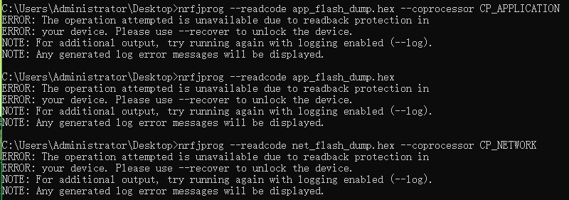

Hi
test it on nRF5340-DK
when no call nrf_debug_port_disable()
when call nrf_debug_port_disable() (even no
Best regards
