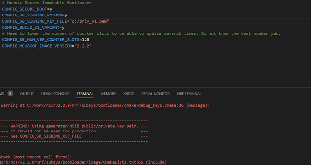

I'm trying to assign custom keys to the immutable nrf secure bootloader and to the updatable mcuboot, but without luck. I still get warning messages from both bootloaders regarding development keys still being used
snapshots of the prj.conf and mcuboot.conf

# Nordic Secure Immutable Bootloader
CONFIG_SECURE_BOOT=y
CONFIG_SB_SIGNING_KEY_FILE="priv.pem"
CONFIG_BUILD_S1_VARIANT=y
# Need to lower the number of counter slots to be able to update several times. Do not know the best number yet.
CONFIG_SB_NUM_VER_COUNTER_SLOTS=120
CONFIG_MCUBOOT_IMAGE_VERSION="2.2.2"

even I've tried to assign the key directly inside the bootloader/mcuboot/boot/zephyr/prj.conf but I got the same result even though the output log shows that priv.pem is used
  The key type is ecdsa-p256
updating the bootloader and the application works fine but still uses the development keys.
Could you please tell me what else I can do to solve this problem?
