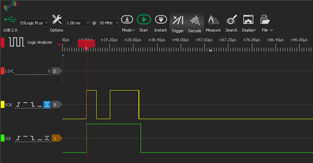

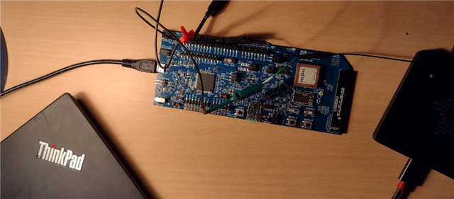

i2c_write_dt gives me -EIO
I followed the tutorial in the DevAcademy nRF Connect SDK Fundamentals where we try to establish an I2C communication. I managed to compile it, but the i2c_write_dt functions gives me an -EIO (general input / output error). Even the logic analyser on pins P0.31 and P0.30 gives some strange pulses. I have seen on some sites that you have to configure the i2s, but I have not found on how to do that in Nordic's examples or in the nRF Connect SDK Fundamentals course. There are some examples on the websites, but there either deprived macro functions are used or they do not work for this board.
Could some give me some ideas why is not working?

  • snip from the logic analyzer view
  • nRF 9160 board

  • Okay, now I understand. The pins should normally  be configured as open-drain. They can only pull to ground. I don't know where and how this is done in Zephyr.
    I will get an I2C sensor with pull-ups to test if this is the case.

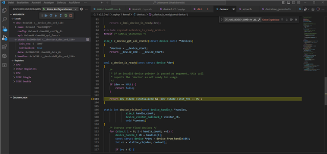

  • Hi Einarh, thanks! That was the issue. I can now use the I2C bus. However, I have another problem on a similar matter. I am now using the BME680 Sensor from Bosch. I decided to take the library from zephry and did some configuration to make it compatible to nrf9160.  I can compile it, but at run time the function device_is_ready() fails.It fails on this line:
    Basically, the dev->state->int_res should be 0, but it is 5, which in the errno.h is I/O error. Why is that so? Below are the files:
    main.c
