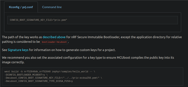

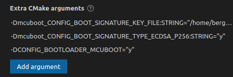

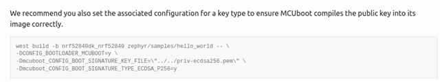

    The manual has .conf options every time, but not here. It does not notice about the child_image directory option. I've no idea how to get this into my nrf-connect build configuration:
    Whatever I try, It doesn't compose the appropriate build parameters.
    Does the build system not automatically detect your child_image directory at all? I just tested on two projects and they work fine.
    The documentation for that is here: https://developer.nordicsemi.com/nRF_Connect_SDK/doc/latest/nrf/app_dev/multi_image/index.html.
    The particular section is Image-specific variables.
