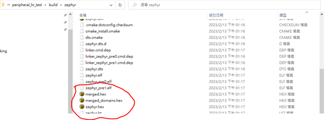

Hex file explain about 5340 development
      A simple question about 5340 hex image needs you to clarify.
I use vscode to create a example(zephyr/samples/bluetooth/peripheral_hr) with 5340 board config. Then I rebuild it and get some HEX file in build folder.
As far as my understanding.
merged.hex and zephyr.hex -> The two are the same, representing the image of the application core
merged_domains.hex -> Represents the merged image of application core and network core
So as long as I only need flash merged_domains.hex , it means that I have burned a dual-core image, and the example can also be executed smoothly.
If I am sure that I will not change the source code of the network core, I will always develop my project like this.
Is it right?
Thank you.
