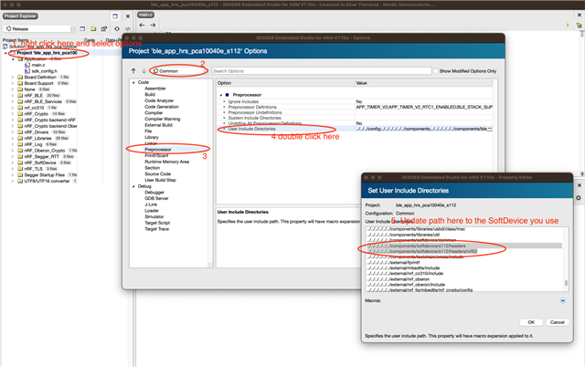

Ble_scan.h header file is not found while I`m working on the code below I`m searching for BLE scan code for nearby devices on PCA10040e board.

    If the compiler does not find the header file it means it is not in the include path. There is no ble_scan.h file in the SDK, though. Did you mean nrf_ble_scan.h? This is for the module (components/ble/nrf_ble_scan/).
    Also, remember that in order to scan you need to use a SoftDevice that supports the central role. See the overview of the SoftDevices.
  • Thanks Einer for answering, Basically the problem is that while I`m working on this code . There is no such example for BLE Scanning present in the examples and then when I switched to nrf_ble_scan.h . The Header source file are showing errors like this is my modified code -

    And the errors I`m getting in the nrf_ble_scan.h file associated with my code =            Rebuilding ‘ble_app_hrs_pca10040e_s112’ from solution ‘ble_app_hrs_pca10040e_s112’ in configuration ‘Release’

    expected specifier-qualifier-list before 'ble_gap_scan_params_t'
    expected specifier-qualifier-list before 'ble_gap_evt_adv_report_t'
    unknown type name 'ble_gap_scan_params_t'
    'NRF_BLE_SCAN_BUFFER' undeclared here (not in a function); did you mean 'NRF_BLE_SCAN_DEF'?
    unknown type name 'ble_gap_scan_params_t'; did you mean 'ble_gap_sec_params_t'?

    'nrf_ble_scan_evt_filter_match_t' has no member named 'p_adv_report'

  • Anshajm9 said:
    Can you please tell me what changes do we need to make in this code to make it implementable .
    You need to move to a SoftDevice that support the central role. Please refer to the table I linked to in my initial post to see which that are.
    In practice, you need to change the include path of the SoftDevice headers to the path to the headers for the new SoftDevice. And change the application start address to the size of the new SoftDevice (you can see this in the release notes of the new SoftDevice or refer to an example project that use that SoftDevice. And lastly, update the processor definition for the SoftDevice in your project configuration (now you have a S112, change that to whatever the new SoftDevice is).
    Anshajm9 said:
    Or How could I write a code for BLE Scanner that scans all nearby ble devices and dumps complete data on RTT viewer.
    Firs to of all, you must pick a SoftDevice that actually make this possible. Secondly,  take a look at a central example for how to do scanning. Essentially just remove most of the sample related to services etc, and scan without any filter. See this post for more details. You could also look at this old post which use SoftDevice APIs directly.

  • If you switch to S132, then you not only need to use the S132 header files, but you also need to update your project in a few more ways:
    • Remove the S112 define and define S132 instead
    • Update the application flash start address to the size of S132 (this depends on the version, so check the release notes of the version you are using)
    You may also need to do some other changes (like change the application RAM start address, but if that is needed you will get an error. Or you culd just mump it up a bit to be on the safe side (unlike the application flash start address, the RAM start address does not have to be exact, as long as it is not too low, while still leaving enough room for the application RAM requierments).
    To see an example of all this, you can take an example proejct in the SDK, and diff the project file(s) for a S112 with the project files for S132 for the same device. You will also see other unrelated changes then as typically those would also be projects fro different ICs, but you will see what I described earlier in this post.
    Regarding the build errors you get, start at the top and resolve them one by one (most likely the same root cause is responsible for many of the errors). For instance, "unknown type name 'ble_gap_scan_params_t'" means that ble_gap_scan_params_t is not defined. This is defined in ble_gap.h for the SoftDevices that support the central role, so as you get this, it indicates that you are still using the header files fro S112.
  • so as you get this, it indicates that you are still using the header files fro S112.
    Einar can you tell me , what would be the proper solution to it? like how can one add those header file present under soft device header`s folder and link them in our program? AND FOI I`m using ble_app_hrs example . removed everything and doing a fresh start .
  • You need to change the include path to point to the right SoftDevice headers. Exactly how to do this is different for each toolchain version, but all have a way to change the include path.This is a key feature for any C project so you need to learn this. If you use Segger Embedded Studio, see here:
    PS: Note that the S132 is not supported on the nRF52810 (though most will work), and you may also find yourself quickly run out of space, so if you need more features you may want to consider going for a larger device.
