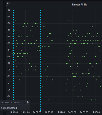

I have a case of different RSSI readings in different environments which is totally normal. The tricky thing is that our RSSI is the same value on 12m as it is few cm away from nRF52832 scanning chip. And it's roughly -62! That's not just on nRF52832/52840 but phones also exhibit this behaviour. This is a difference in RSSI range between two places we are testing in is visible on the plot below:
The site on left a big open space with some metal, non heated space (it's cold but above 0°C) with wrought 30 BLE emitters. The one on right is office space with normal temperature with hundreds of BLE advertisers.
Since RSSI uses a noise floor as reference I decided to change it with DTM firmware and emitted a constant carrier on CH 37-39 to see what happens in the office space. And the results looked like in this screenshot.

    3. I established a connection not in the actual environment but in my dev setup where RSSI behaves normally. Indeed RSSI difference can be observed. In the attached screenshot first range from the vertical line is not connected, second is when i kept a idle BLE connection to the device. Short interruption was caused by script which measured the RSSI and not the actual device
