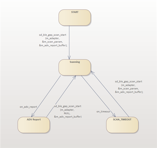

I'm using the the pc_ble_driver and want to scan BLE devices with legacy and extended pdu.
My problem is that scan responses only reached sporadic my callback.
Init:
sd_ble_gap_scan_start(m_adapter, &m_scan_param, &m_adv_report_buffer);
in Callback
static void on_adv_report(const ble_gap_evt_t *const p_ble_gap_evt)
sd_ble_gap_scan_start(m_adapter, NULL, &m_adv_report_buffer); //continue scanning
Sometimes i get a timeout:
static void on_timeout(const ble_gap_evt_t * const p_ble_gap_evt)
sd_ble_gap_scan_start(m_adapter, &m_scan_param, &m_adv_report_buffer); //restart scanning in case of timeout => but why?
Is something wrong with my scanning process? As i understand, i need to restart scanning after EACH report. (only after BLE_GAP_ADV_DATA_STATUS_INCOMPLETE_MORE_DATA, but this is here not the case)

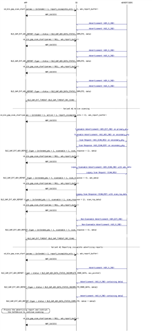

See Sequence for Scanning:
Different View:

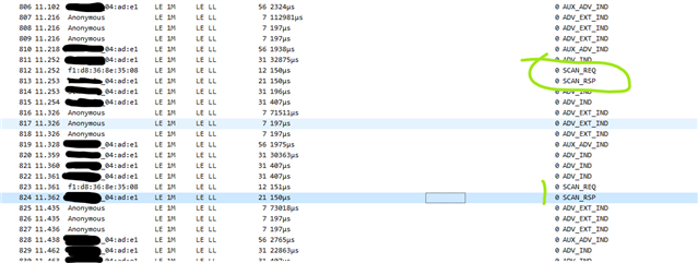

Sniffing with Wireshark looks ok. Scanning Requests and Responses are there. So it seems some kind of receiving issues.
    What SD_API version are you using in your pc-ble-driver app (and on the connectivity device)? If you are using the latest version, there was a change in the softdevice that made it difficult to be able to pick up scan responses, because of the delay from the advertising event -> serial -> decide to continue scanning -> serial -> actually resume scanning. The time it takes for this round trip to complete takes a bit of time, and in many cases, the scan response is done by the time you resume scanning.
    If possible, try to stick to the older version of the pc-ble-driver if you are dependent on scan responses. SD API 5 and earlier will not have this issue.
