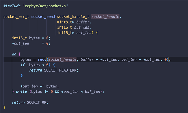

    This is how I read the data from the socket on the nrf9160, both string formatted and binary.
    Function to read incoming bytes

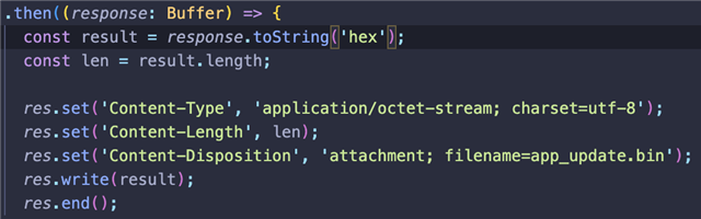

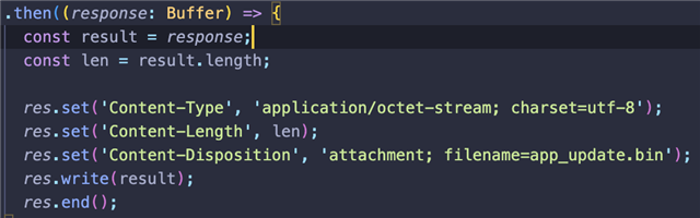

    Here's how the nodejs express server returns the bin currently, where response is just an array of the bytes.
    Binary version
    Data sent in binary form
    Hex string version
    Data sent in a hex string format
    When I test this in Postman or download it directly to my computer through the API it works with the binary version, but when I try to download on the NRF9160 I get the wrong bytes, although when I convert it to a string in a hex format I then receive it correctly.
