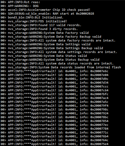

This implementation is working if we force an App Error Fault. We've implemented a BLE command that will simulate an App Error, like so:
    case APP_CMD_SIMULATE_ERROR_FAULT:
        APP_ERROR_CHECK(1);
In the RTT Viewer it is possible to see that the app_error_handler() implementation works:
app_error_handler-successful-print
But when the error occurs, the file name and line number aren't printed.
Instead, the debugger prints out a series of AppErrorFault! calls with a decreasing id by 0x68 each line:
AppError-debug-loop
This keeps happening until the watchdog times out and resets the device (as can be seen at the start of the print).
Then it happens again during initialization of the device.
To me it looks like the app_error_handler() has an App Error in it and is catching itself.
You can find an excerpt of the RTT Viewer debug log here.
To me, this looks like some sort of corruption of the application during DFU.
But shouldn't the bootloader check the contents of the application after DFU before rebooting into it?
Has this ever happened to anyone before?
What more steps can we take to diagnose this further?
Please let me know if there's any more information I should provide.
Thank you in advance for your time and help,
 - BBFonseca

    BFFonseca said:
    Would this be expected?
    It works in later SDK versions, but I see that this is expected behavior on SDK 12.3.
    BFFonseca said:
    Also, how can I obtain this .elf file? I'm not using Segger, I'm building with the CLI using make.
    You might be getting a .out file in that case.
    I agree, maybe try removing  display_set_pattern(CHARGING_PATTERN); ?
