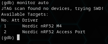

  • I replaced the old Microcontroller with a brand new one, and the board immediately appears to function. My blackmagic probe immediately detects the target.

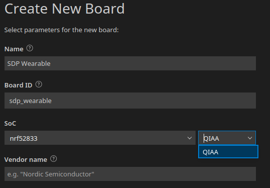

    I'm a little hesitant to just attempt to flash this however, and am curious if you can provide a little more information on board configuration and setup. Within the NRF Connect SDK, I only see an option to create custom hardware using the aQFN (QIAA) version of this package.
    As far as I understand, all packages contain identical silicon, simply with more or less pins exposed. Is it safe to create a program around the QIAA, and flash it to the QDAA? Or is there some special configuration I need to perform?

  • All variants of the nRF52833 has the exact same design, but you will have to note that some gpios are ofc not available on the QDAA variant. If you base the the board of the QIAA/nRF52833DK be aware of any 'default' pins in the QIAA devicetree. I.e. uart0 might have assigned gpios that are not available to the QDAA variant. You just need to double-check en change any such configuration.
    Note that you are still operating the device out of spec and you will likely experience issues in the near future. If you connect the VDD vias with wires you might be able to mitigate a few of the impending issues.
    You are kinda on your own here, we can't help you debug any issues as long as you're running off a faulty power supply.
