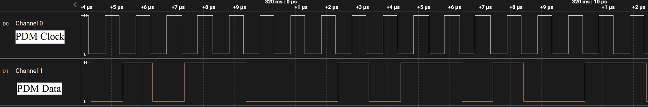

Hello, I'm trying to use two microphones in stereo mode of PDM (nrf52832, SDK17). Unfortunately, I have a major problem with my Right microphone. It seems that "nrfx_pdm_buffer_set" just put the Left one in the buffer.
This is my initialization for PDM in main function:
int main(void) {
    nrfx_pdm_config_t pdm_config = NRFX_PDM_DEFAULT_CONFIG(PDM_CLK_PIN, PDM_DATA_PIN);
    pdm_config.mode = PDM_MODE_OPERATION_Stereo;
    pdm_config.gain_l = PDM_GAIN;
    pdm_config.gain_r = PDM_GAIN;
    pdm_config.clock_freq = PDM_PDMCLKCTRL_FREQ_1000K; // 15625 Samples per Second
    pdm_config.edge = PDM_MODE_EDGE_LeftFalling;
    pdm_config.interrupt_priority = APP_IRQ_PRIORITY_HIGH;
    err_code = nrfx_pdm_init(&pdm_config, pdm_event_handler);

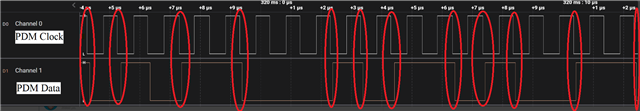

  • I do not agree. As I can see PDM_DATA has both 0 and 1 in falling and rising of PDM_CLOCK. There must be a problem with my code or SDK as I mentioned before.
    I don't understand what you are seeking for when you say: "And the microphone behaves like this both if you connect LR to GND or VDD? It always changes on HiToLo?"
    I used 2 microphones on my own-designed PCB and I want to use them in stereo mode. My code doesn't detect anything from the right microphone (all data is captured from left one). Please take a look at my code or the problem may happened due to a problem in nrfx driver.
