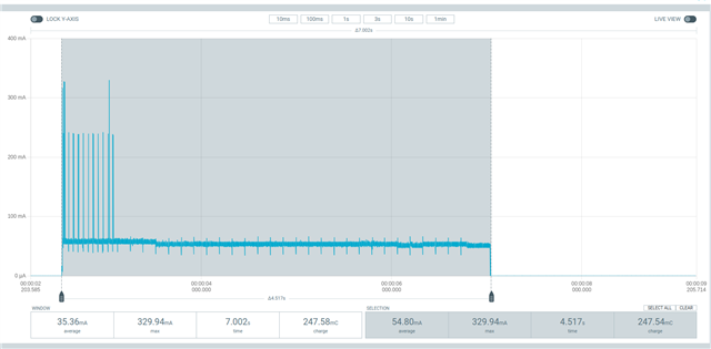

Depending on how many beacons the nRF receives, you will also have active probe of the AP. Here's an example of scanning and finding 11 APs within my range:
You can use the "shell" sample to actively scan.
